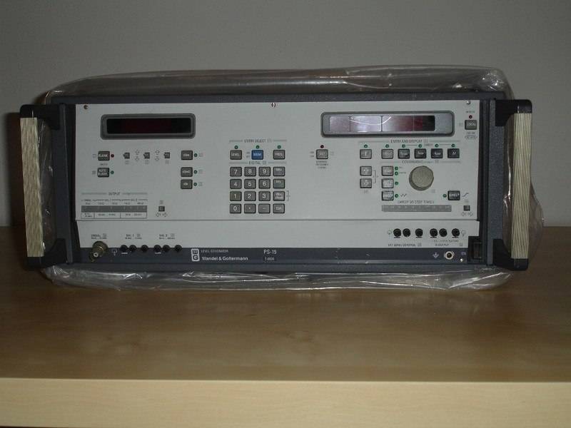

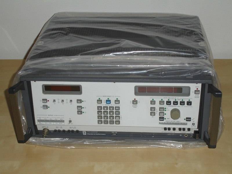

Here are the images.
I think it could be a special kind of signal generator used in the communication networks. Perhaps the networks of new generation are different and so these equipment has no purpose anymore ( it could be the reason why I could get it for that cheap price ) ?

That's basically a synthesized sweep signal generator with multiple outputs with different output impedances that are often used in communication.
It's hard to say from the pic what the frequency range is, but it should work up to 2 MHz on the black pin connectors, and perhaps higher on the BNC connector.
When powered up, you should be able to type a frequency of the signal you want, and its amplitude. Or, in sweep mode, the start and stop frequency, and sweep time.
You could probably connect the x-axis to an oscilloscope (in xy mode) and you will have a nice scalar network analyzer to analyze filters, transmission lines, or amplifiers.
