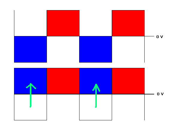

With a true square wave and a resistive load, you can work out the RMS power by inspection.
The power is just the peak voltage times the peak current. See diagram. The voltage and current can be redrawn as a DC voltage and current.
If the voltage is a DC pulse, ie with no negative (or no positive ) component, The power is the peak voltage times the peak current times the duty cycle.
However, if the load is not resistive, simple solutions become impossible and you have to start measuring when current flows at the same time as voltage is applied.
You also have to consider whether you are obsessive enough to care. :)

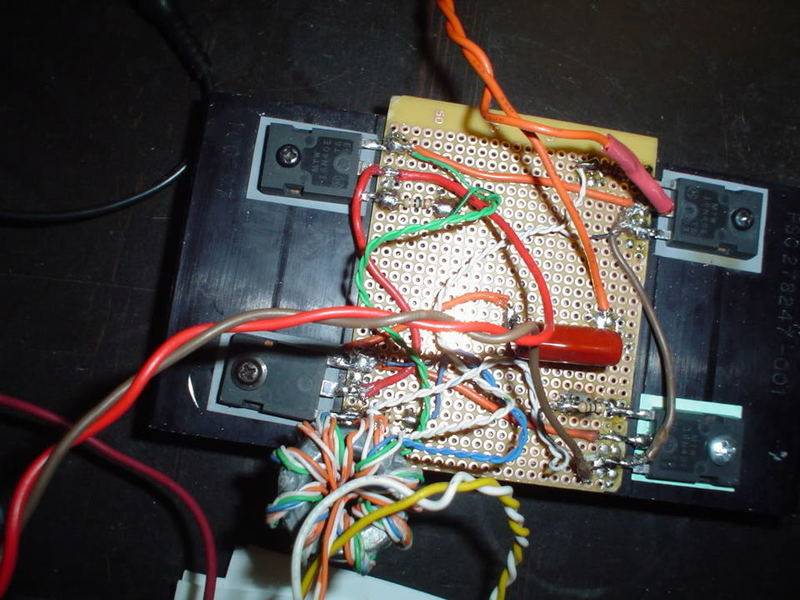

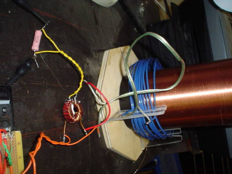

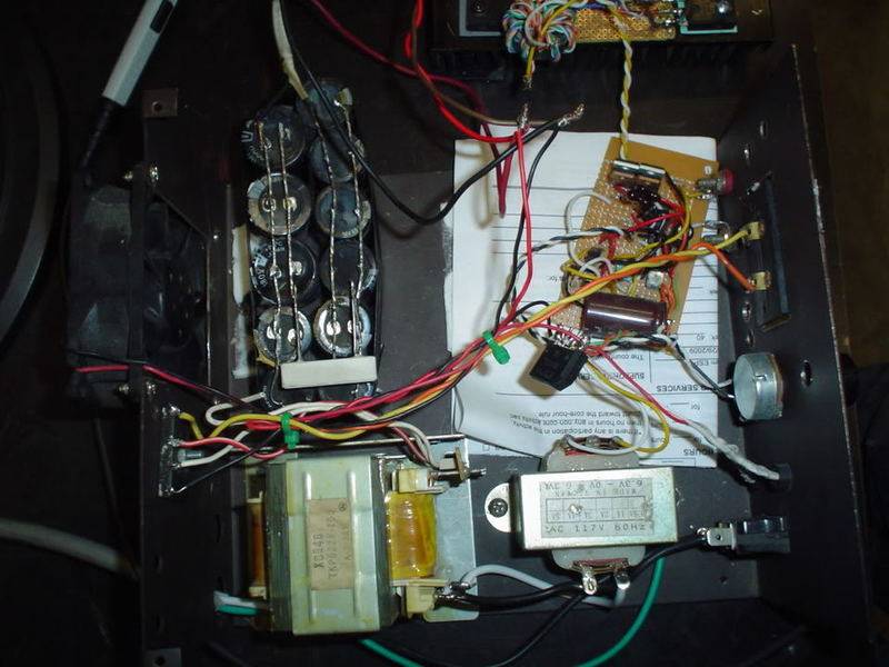

Ive added some photos for you, the two orange wires are the full bridge ac output @172Khz, one goes to the TC primary, the other goes to the two turns on the current transformer (looks like a filter torrid) the secondary has another 33 turn winding on it, which is connected to the two smaller yellow wires, connected to the pink-ish 1.5ohm, 5W, Non inductive resistor with the scope probe connected. Scope is set to 1V/Div and .2uS/Div. and I am getting a sinewave 1VPk out of the current transformer. Voltage is simply the DC input voltage to the bridge from the large transformer in the back of the box.
