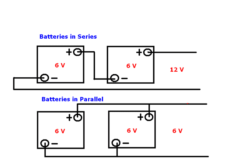

I am trying to understand a personal dilemma. I would like to hook up an automobile headlight bulb to a custom made battery pack. What I don't understand is how amps are related to the circuit. Let's say I took (2) 6volt lantern batteries and wired them in a parallel circuit. Now that would be 12volts correct? So now I know that I have the correct voltage to power the headlamp.
Now let's say the headlight bulb is rated a 55watts. So 55/12=4.58. So that means the bulbs require 4.58amps, correct? I know the amperage of the fuse that the headlights came from was a 15amp fuse. I don't understand how to test/ know whether or not the 2 6volts batteries wired in parallel have the proper amount of amperage. Is it as simply as hooking up a multi meter and test the amps of the circuit "shorted"(without the headlight wired up?) or is there more to it?

I guess that was a typo. The batteries give 12 volts if they are in series. They give 6 volts if they are in parallel.
If you put a 12 V 55 watt lamp across 12 V it will draw 4.58 amps and dissipate 55 watts.
On 6 volts it would draw less current but probably not exactly half of 4.58 amps.
Testing batteries has to be done safely. If you just shorted out a car battery there could be an explosion, melted wires, a fire or other mayhem.
So, you put a known heavy load across the battery and measure the voltage drop. Then you can calculate the short circuit current.
More useful is the ampere-hour figure for the battery. You need to know how long a battery would last if it was supplying 10 amps, for example.
A lamp will burn out if it gets too much voltage. You can't make a lamp draw too much current if it doesn't get more than its rated voltage.
