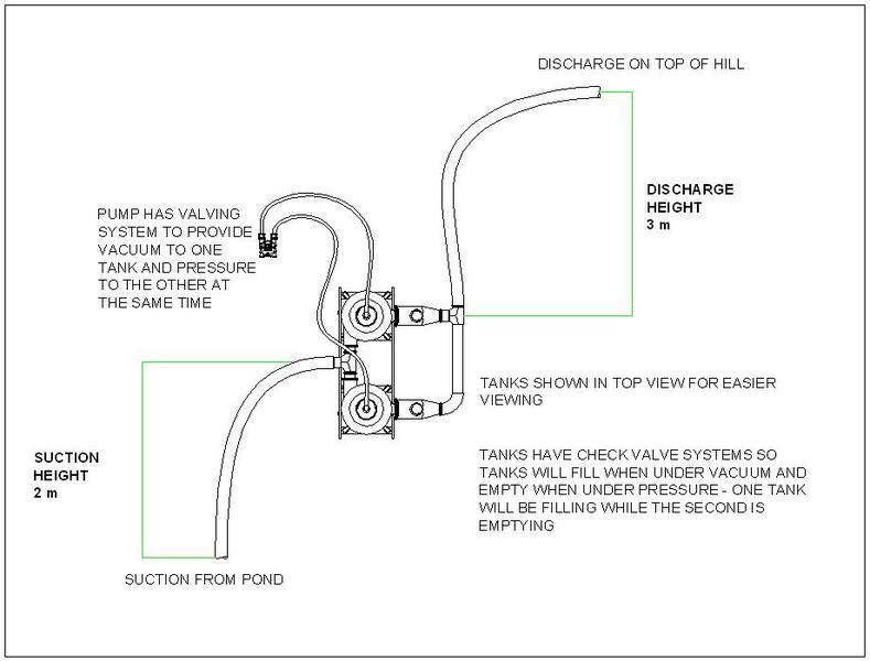

I am trying to move water using a vacuum pump. I have a vacuum pump hooked up to a tank that has one inlet, one exit with a length of hose and check valves on both. What I am doing is creating a vacuum in the tank, causing water to fill the tank. Then using the pump to generate pressure in the tank to discharge the water. I know the pressures/vacuum required to lift/push the water for my suction and discharge heights. As well as the flow rate of the pump. What I need to do is calculate the flow rate of the water into/out of the tank. My pump supplier has said to use Boyle's Law (P1V1=P2V2). The time this yeilds is close to real world results, however, in my mind it doesn't add up. It would make sense if I was moving air, but I am using the air to move water. The flow rate of the water has to be the same at both ends of the hose, as water will not compress or expand. I have since started trying to use Bernoulli's Equation (V^2/2+P/d+gZ=const), this makes more sense as it relates velocity (which leads to flow rate) to pressure. Since I am using pressure differential to move the water, I feel this is the equation I should be using. When I do all the calculations the results from Bernoulli's is way faster then the real world expermental data I have. If anyone could give any insight or a push in the right direction that would be great.

maybe I'm just dense today, but I don't see what you're trying to do here. Your original post had a tank and a vacuum pump, now you have a pond, and two tanks and pumps... can you make a sketch of the configuration.
Your first two equations show a pressure difference between suction and discharge of 5 meters, yet you say the elevation of one is 2 meters and the other is 3 meters... What are these 2 and 3 meter elevations with respect to?? Is there a water level in the tank? Sorry, but I just don't have a picture in my mind of your set up...
Here is a picture of what I have.
I started looking at the bernoulli calc you did. The difference between the tank pressure you calculated (81214 Pa) and the pressure at the suction end of the hose (atmospheric, 101325 Pa) is just equal to the elevation head (the 2 meters) - so you have just enough vacuum to raise the column to the height of the tank, with essentially nothing left over for velocity. So the flow should be zero.
I think you need to re-think what the tank pressure is. It begins at atmospheric, right? And then as the vacuum pump draws on the tank, the tank pressure drops and the water column starts to rise. When the tank pressure is "minus two meters" the column has reached the tank. How low will the tank pressure go? Will it evacuate the tank vapor faster than the liquid enters?
