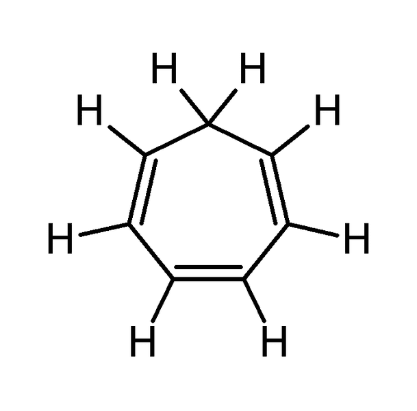

(2) One of the compound containing six pi electron is given "Not Aromatic".
Reason: Cycloheptatriene contains 6 pi electrons but the electrons are only delocalized over six carbon atoms and not over all the seven carbon atoms of the ring. Further more it is not planar. Therefore, it is not aromatic and behaves like a typical alkene undergoing electrophilic addition reaction.
Can You explain me this. Everything going above my head without leaving a single trace of meaning behind.
All right, I'm pretty sure I can explain this.
One of the requirements for aromaticity is a cyclic, conjugated system of pi electrons. Now, what does this mean?

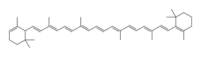

Conjugated refers to a system of alternating single and double bonds. Beta-Carotene is a good example of a conjugated system. However, for a system of pi electrons to be cyclic conjugated, the alternating single and double bonds must go in a circle without
end, creating a ring of pi electrons above the molecule. A quick look at cycloheptatriene shows this; there are two single bonds in a row, so it's not cyclic conjugated.

Sir may I know the structures of A-Carotene...??
Well, I was talking about B-Carotene, not A-Carotene, but here's the structure of A-Carotene.
Note the alternating single and double bonds.

Let's go back to your cycloheptatriene molecule. Now let's say we take away one of the two H atoms from the molecule. Now, there are three possibilities, and two of them have charges. The third is no different from the first.
One possibility is that an H+ ion is taken away, leaving 8 total pi electrons. Now, carbanions like this one usually change from an sp3 orbital to an sp2 orbital and a p orbital... (carbocations do the same thing) so you have 7 p orbitals, making a system. However, this system has 8 electrons in it, and this actually makes the molecule antiaromatic for having electrons 4n. So it doesn't happen.
The other possibility is that an H- ion is taken away, leaving six total pi electrons. 6 is a Hückel number, so the molecule is stable.
Really, you need to look into sp3 and sp2 bonds to get it...
