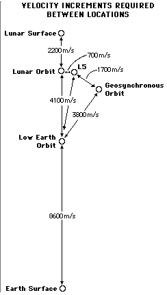

These are a few things I found on my own:
Rocket equation: http://en.wikipedia.org/wiki/Tsiolkovsky_rocket_equation
Delta-V calculator: http://www.talisiorder.ca/worldbuilding/rocketequation.php
Target velocities:
So, should I really be asking how much force is needed to reach 12 or 13,000 m/s?1

Delta-v from LEO to the Earth-Moon L1 point is about 3,800 m/s.
About the Earth-Moon L1 point. This is *not* the point where the Moon's gravity cancels that of the Earth. If the Moon was not there, an object at the L1 point would orbit the Earth in less than 27.32 days. The Moon is there of course; it's gravity reduces, but does not cancel, the Earth's gravitational influence. The reduction is just that needed to make the object orbit the Earth in 27.32 days.

Once you get to orbit, it is not that hard to calculate the requirements to transfer from one orbit to another. What you can do is just find the difference in the specific energies of the two orbits. Once you know what thing you are orbiting (Earth in this case), the specific energy of an orbit is only dependent on the equivalent circular radius of the orbit, IOW the altitude.
Specific Energy is the energy of the orbit divided by the mass of the thing orbiting (your 10 kg). We use specific energy because then we can talk about the subject of orbital transfers without worrying about the mass of the thing transferring. That's the whole thing about delta-v as well: the number applies regardless of what spacecraft mass you are talking about.
The orbital energy is an interesting concept (and I should note that this method of mine is unorthodox and some smart people are going to think I am cheating, if things go the way they usually do - I don't post here much). It is the BOUND energy, representing the energy of the motion of the object in a gravity field (where the numbers give you an elliptical rather than parabolic or hyperbolic orbit). It is actually less the further away you are. A bound energy of nearly zero is what an object just barely within the gravity field has.
On a related note, be aware that 'escape energy' is of virtually no use in these calculations. That term is very mis-used by the, er, curious. Escape energy is that specific energy required to take an object from its current location in the gravity field (usually from the surface of the planet) and apply it all at once and have the thing coast straight up such that it eventually stops and does not return. This has little to no relation to something that would happen in real life, especially since you have to ignore other gravity fields, which is ludicrous in the real solar system. It is called 'escape' because any less energy and you fall back to the surface. It is a (bad) measure of gravity field strength.
So once I give you the equation, it will be simple (for those used to plugging numbers into an equation and turning the crank correctly): You find the radius of the starting orbit, which is actually the same thing as the "semi-major" axis of a real-life elliptical orbit. You plug that in and get the starting orbit's bound energy. Then you use the L1 altitude to find the bound energy of the second orbit. Take the difference, and you have the energy change. From there you use the equation for Kinetic energy to convert to delta-V. Real-life "gravity losses" are ignored here.
This delta-V number does not tell you how much dV is needed for the first burn vs the second burn, it is just the total. You need to solve for the parameters of the transfer orbit to get the allocation between the two rocket engine burns.
