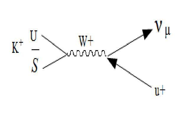

billbray
24
I've attached a feynman diagram i drew myself because i can't find a proper feyman diagram for this decay. I assume that since the decay K+->u+ + Vu is weak it goes via a W boson.
Is this diagram correct?
thanks

The diagram is correct. IcedEcliptic is talking about another decay channel.
Sorry, my mistake.
thanks guys!
