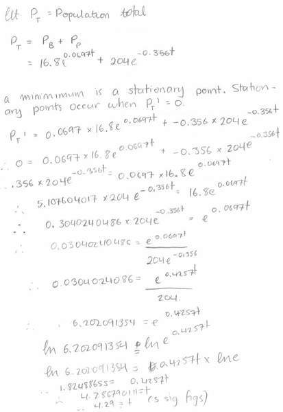

Calculate the minimum of PT = 16.8e0.0697t + 204e-0.356t
PT' = 0.0697 x 16.8e0.0697t + -.356 x 204e-0.356t
Stationary points occur when PT'=0. Therefore:
0=0.0697 x 16.8e0.0697t + -.356 x 204e-0.356t
My final answer was that t = 4.29. However, the Graphics Calculator begs to differ and says that it is 5.695.
Attached is my working; where have I gone wrong?

Procrastinate said:
Was that using the natural logarithm or an exponent?
Up to this point you were doing well, then you decided to start dividing and made an error. Try by multiplying it out first then dividing:
0.356*204*exp(-0.356*t) = 0.0697*16.8*exp(0.0697*t)
It should be
72.624*exp(-0.356*t) = 1.17096*exp(0.0697*t)
62.020*exp(-0.356*t)=exp(0.0697*t)
62.020=exp(0.0697*t)/exp(-0.356*t)
ln(62.020)=ln(exp(0.4257*t))
4.1275 = 0.4257*t
t=9.6957
In your work, you seem to have changed 0.30 ... into 0.030... a little below the middle of the page.
I did that and now I get 9.695...
I rectified that afterwards. Perhaps what I graphed into my Graphics Calculator is wrong.
It is. Silly me.
