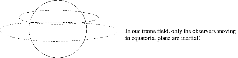

OK, on to the debunking. To avoid repeating in detail things I've said more than once in the past, I'll only sketch a simple approach using frame fields:
At each event in the exterior region, boost the frame field modeling static observers
[tex] \begin{array}{rcl}<br /> \vec{f}_1 & = & \frac{1}{\sqrt{1-2m/r}} \; \partial_t \\<br /> \vec{f}_2 & = & \sqrt{1-2m/r} \; \partial_r \\<br /> \vec{f}_3 & = & \frac{1}{r} \; \partial_\theta \\<br /> \vec{f}_4 & = & \frac{1}{r \, \sin(\theta)} \; \partial_\phi<br /> \end{array}[/tex]
first in [itex]\partial_r[/itex] direction by [itex]\alpha[/itex] and then in the [itex]\partial_\phi[/itex] direction by [itex]\beta[/itex], with these boost parameters depending only on r. Then with
[tex] p = \sinh(\alpha), \; q = \sinh(\beta)[/tex]
treated as undetermined functions depending only on r, the new frame field is:
[tex] \begin{array}{rcl}<br /> \vec{e}_1 & = & \sqrt{1+q^2} \; \left(<br /> \frac{\sqrt{1+p^2}}{\sqrt{1-2m/r}} \; \partial_t<br /> + p \, \sqrt{1-2m/r} \; \partial_r \right)<br /> + \frac{q}{r \sin(\theta)} \; \partial_\phi \\<br /> \vec{e}_2 & = &<br /> \frac{p}{\sqrt{1-2m/r}} \; \partial_t<br /> + \sqrt{1+p^2} \, \sqrt{1-2m/r} \; \partial_r \\<br /> \vec{e}_3 & = & \frac{1}{r} \; \partial_\theta \\<br /> \vec{e}_4 & = & q \; \left( \frac{\sqrt{1+p^2}}{\sqrt{1-2m/r}}<br /> \; \partial_t <br /> + p \, \sqrt{1-2m/r} \; \partial_r \right)<br /> + \frac{\sqrt{1+q^2}}{r \sin(\theta)} \; \partial_\phi<br /> \end{array}[/tex]
Now demand that p, q are such that
[tex] \nabla_{\vec{e}_1} \vec{e}_1 = 0[/tex]
in the equatorial plane [itex]\theta=\pi/2[/itex]; to prevent possible misunderstanding, see the sketch below. (By the spherical symmetry, our analysis holds true for any other coordinate plane "through the origin", and since all geodesic motion is planar in that sense, for any timelike geodesics). We find that
[tex] q = J/r, \; \;<br /> p = -\sqrt{E^2/V-1}, \; \;<br /> V = (1-2m/r) \; (1 + J^2/r^2)[/tex]
where V is of course the usual effective potential, J is the angular momentum in the equatorial plane of the test particle, and E is its energy (where strictly speaking, one obviously has to say more about where and how these quantities are to be measured, which I won't bother to do.)
When p is nonzero, p < 0 corresponds to the phase of history (when it exists) when the observer is moving inwards (r is decreasing), and p > 0 for the phase (when it exists) where the observer is moving outwards. Some motions include only outward or only inward motion.
This frame field is only valid where the chart is valid (on the exterior region), but a similar approach can be adopted for a frame field such as the slow-fall frame, written in Eddington influx chart, where the frame field and local coordinate chart are both valid on the future interior region as well as exterior region. In the case of planar motion which falls inside the event horizon, this allows us to continue the history of our observer.
The case J = 0 recovers the motion of test particles which are moving purely radially (in particular, the Lemaitre observers who fall in freely and radially "from rest at r=infty"). For small J/E there is no turning point and such observers invariably enter the event horizon. The "shape" of the planar trajectories is in fact determined by J/E alone.
Those of you who use GRTensorII under Maple can painlessly verify by direct computation that this procedure does indeed yield timelike geodesics representing planar motion in the equatorial plane. Furthermore, the curvature components measured by an inertial observer moving in the equatorial plane are
[tex] \begin{array}{rcl}<br /> {E\left[\vec{e}_1\right]}_{ab} & = &<br /> \left[ \begin{array}{ccc}<br /> \frac{-2m}{r^3} \, \left( 1+\frac{3J^2}{2r^2} \right)<br /> & 0 & 0 \\<br /> 0 & \frac{m}{r^3} \, \left(1+\frac{3J^2}{r^2} \right)<br /> & 0 \\<br /> 0 & 0 & \frac{m}{r^3}<br /> \end{array} \right] \\<br /> && \\<br /> {B\left[\vec{e}_1\right]}_{ab} & = &<br /> \left[ \begin{array}{ccc}<br /> 0 & 0 & 0 \\<br /> 0 & 0 & \frac{-3mJ}{r^4} \, \sqrt{1+\frac{J^2}{r^2}} \\<br /> 0 & \frac{-3mJ}{r^4} \, \sqrt{1+\frac{J^2}{r^2}} & 0<br /> \end{array} \right]<br /> \end{array}[/tex]
It is striking that these expressions (which turn out to remain valid for observers who move into the future interior region) do not depend upon E. This generalizes a well known remark of MTW concerning purely radial motion.
The given frame field is inertial (in the equatorial plane, assuming we have substituted the expressions for p,q I gave above), but the spatial frame is spinning, in general, as we move along an integral curve of [itex]\vec{e}_1[/itex]. Specifically, in the equatorial plane, the spatial frame is spinning with "spin axis" given by the spatial frame vector [itex]\vec{e}_3[/itex]. To fix that, we can introduce a secular spin about [itex]\vec{e}_3[/itex] with a rotation rate which is given by a third undetermined function of r only. Then demanding that the Fermi derivatives vanish gives the desired nonspinning inertial frame. This procedure does not change [itex]\vec{e}_1[/itex], whose integral curves give the world lines of our observers.
To reiterate, so far I have been discussing the motion of general inertial test particles whose motion is confined to the equatorial plane (or by spherical symmetry, to any other coordinate plane "through the origin").
Now, when [itex]E^2 = V[/itex], r is obviously constant (since the [itex]\partial_r[/itex] component drops out of [itex]\vec{e}_1[/itex]), so this condition gives the Hagihara observers who move in circular orbits (which are stable against small in-plane perturbations by the usual analysis in all the textbooks). So these observers certainly exist.
The easiest way to find the frame of a Hagihara observer explicitly is probably to repeat the above but boosting the frame of a static observer only in the [itex]\partial_\phi[/itex] direction. Then we find that for a Hagihara observer orbiting at r=r0 (where r0 > 3m) we must take
[tex] J = \pm \sqrt{ \frac{m \, r_0}{1-3m/r_0}}, \; \;<br /> E = \sqrt{1-2m/r_0} \, \sqrt{1+\frac{m/r_0^3}{1-3m/r_0}}[/tex]
The frame field becomes (for one choice of sign):
[tex] \begin{array}{rcl}<br /> \vec{e}_1 & = & \frac{1}{\sqrt{1-3m/r}} \; \partial_t<br /> - \frac{\sqrt{m/r}}{\sqrt{1-3m/r}} <br /> \; \frac{1}{r \, \sin(\theta)} \; \partial_\phi \\<br /> \vec{e}_2 & = & \sqrt{1-2m/r} \; \partial_r \\<br /> \vec{e}_3 & = & \frac{1}{r} \; \partial_\phi \\<br /> \vec{e}_4 & = & <br /> \frac{-\sqrt{m/r^3}}{\sqrt{1-2m/r} \, \sqrt{1-3m/r}} <br /> \; \partial_t + \frac{\sqrt{1-2m/r}}{\sqrt{1-3m/r}} <br /> \; \frac{1}{r \, \sin(\theta)} \; \partial_\phi<br /> \end{array}[/tex]
Again, it must be understood that an integral curve of the timelike unit vector field here, [itex]\vec{e}_1[/itex], is only a timelike geodesic for the case [itex]\theta=\pi/2[/itex]; then we have the following simple expression for the proper time parameterized world line of a Hagihara observer orbiting at r=r0 where r0 > 3m:
[tex] \begin{array}{rcl}<br /> t & = & t_0 + \frac{s}{\sqrt{1-3m/r_0}} \\<br /> r & = & r_0 \\<br /> \theta & = & \pi/2 \\<br /> \phi & = & \phi_0 - \frac{s \, \sqrt{m/r_0^3}}{\sqrt{1-3m/r0}}<br /> \end{array}[/tex]
The other integral curves give circular orbits lying in some coordinate plane "parallel to" the equatorial plane, which naturally have a nonzero constant acceleration.
Now the proper time parameterized integral curve I just wrote down is very simple, and anyone can easily plug it into the geodesic equations for the Schwarzschild vacuum, written in the Schwarzschild chart on the exterior region, and see that this is indeed a timelike geodesic. So the claim of Hioe and Kuebel is manifestly wrong: Hagihara observers do exist! Just as all the textbooks say.
The "orbital frequency" for an observer orbiting at r=r0, as measured by a static observer "at r=infty", is given by
[tex] \frac{d\phi}{dt} = \pm \sqrt{\frac{m}{r_0^3}}[/tex]
(same as Kepler expression); the proper time frequency is however
[tex] \frac{d\phi}{ds} = \pm \sqrt{1-3m/r0} \; \sqrt{\frac{m}{r_0^3}}[/tex]
and then there is an additional problem in deciding how the orbiting observer is to determine that he has just completed "one orbit"--- in fact, what I just wrote is the orbital frequency with time measured by our Hagihara observer but completion of an orbit determined by a distant static observer, which may not be quite what we want. So... some things are just plain tricky! And something funny happens to the vorticity at r=6m, which is the location of the "last stable circular orbit"!
As already noted for the general case, the given frame is inertial but it is spinning within the equatorial frame. By introducing a secular rotation with a rate which is given by some undetermined function of r only, and requiring that the Fermi derivatives wrt e_1 vanish, we can find the nonspinning inertial frames of the Hagihara observer at r=r0. Then the precession wrt the distant stars agrees with the expression found by Rindler and Perlick.

Figure:
  • Sketch of the circular trajectories obtained from the integral curves of [itex]\vec{e}_1[/itex], where sphere indicates some sphere [itex]r=r_0[/itex] where [itex]r_0 > 3m[/itex].
