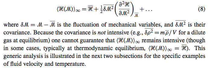

For example, I don't understand equation (8):
Is that a Taylor expansion? I understand what <H(M)>_S is, I just don't understand how it's equal to that.

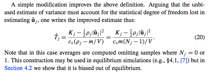

I also don't understand the modification you do here to improve the definition of temperature based on the instantaneous internal energy per particle:
I see that you factored the rho out, but why do you subtract m/V from it? Is that to correct for the samples with N=0 or N=1 that we don't use?
