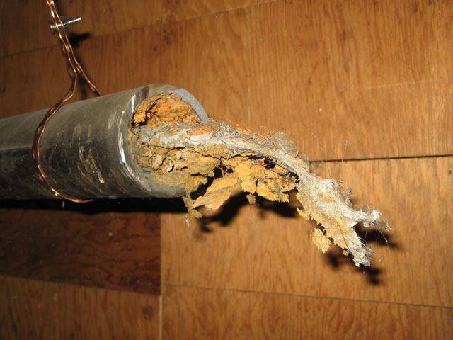

water pipes get enough build up as it is (have you seen the inside of a water main? Quite frankly I've seen more plant life in there than I have in some forests), and having heavy minerals come out of solution would only clog your pipes faster. Mineral build-up on the inside of copper = no good.
We decided that this was a rat that tried to crawl up the pipe and got stuck.
