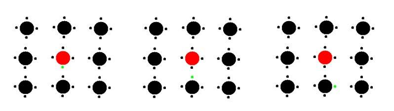

As I understand it, by dative bond you mean that the dopant atom shares two electrons with a host atom, both of which come from the host. This may not be the most useful way to think of it.
Let's just say the lattice is Si. On the left, the hole is with the dopant atom it came from. There are three bonds with adjacent Si atoms, and one broken bond. None of these will be considered dative bonds. Now the hole moves down and over to the right. Ok, the bottom bond of the dopant could be called dative because we know that both electrons involved came from the Si. But this bond is indistinguishable from the other three bonds between dopant and Si. Why call it something different? After a while, you have no idea which electrons came from the dopant. There are about a million Si atoms for each dopant atom. Clearly, NONE of the dopant electrons will be anywhere near the dopant. Are you going to say that it has four dative bonds? That's misleading since it contributed 3/4 of its own bonding electrons.But yes, you're right that the atomic core (nucleus plus valence electrons) is negatively charged relative to the atomic core of the host.

When I say that,I mean that I thought that "VB electrons are more associated with the holes, since the two are constantly being generated in pairs and recombining. "
I think I have an enormous misconception here! I thought the CB electrons are the ones that flow similar to the metal electrons whereas the VB electrons having less energy (and more under the influence of the positive nucleus) are what combine and recombine with the holes!
Thanks for the diagram,johng23. I think I understand what you mean.Even when we did dative bonds in lower classes,our teachers told us that after the bond has been formed,you can't tell it apart from an ordinary coordinate bond.
