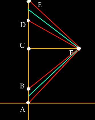

Yes, you've included everything we need to know! Here is a description of the scenario and two formulas you can use to make the calculation that Greene does. I haven't explained the reasoning behind the formulas, how they're derived or the more general formulas that these are special cases of, but maybe this will give you at least a taste for what's going on.
I've drawn a Minkowski diagram (a kind of spacetime diagram) representing your example. The yellow axes are a coordinate system in which Gracie doesn't move. The horizontal axis represents space; we only need to consider one dimension of space for this problem. The vertical axis represents time. In the yellow coordinate system, Gracie's position in space doesn't change. She only moves in time, from event A (where/when George crosses her path at the beginning) to event E (where/when George meets her again at the end). A coordinate system in which an object doesn't move is called it's "rest frame" because the object is at rest in that coordinate system (reference frame).
George travels from A to F. F represents the event of him turning round. Then he goes from from F to E.
If you can draw a horizontal line between two events on this diagram, they happen at the same time as each other in Gracie's rest frame. For example, in Gracie's rest frame, George turns around (event F) simultaneously with whatever is happening in Gracie's life at event C. It's natural for Gracie to think of F as simultaneous with C, although, being wise in the ways of relativity, she knows that C and F won't be simultaneous in all coordinate systems.
Those light blue lines at 45 degrees to the yellow axes are the path that a pulse of light would take through spacetime. I've drawn it to a scale (such as years of time and light years of space) where the speed of light is one, so the slope of the blue lines is 1. The closer George's path is to a blue line, the closer his speed to light speed. Imagine that the slope of his paths are 1/0.995. (I haven't quite drawn them accurately; that would be a bit hard to see.)
I've drawn extra red lines (FB and FD) that make the same angle as George's path, but on the other side of the blue lines representing light speed. (The top set of three slanting lines should really be the same angles apart from each other as the bottom three, but my drawing is a bit rubbish...) These other red lines are lines of simultaneity in George's "rest frames" (those are coordinate systems that moves along with George; coordinate systems where George always has the same space coordinate). There are two of them here: one that moves along with George from A to F, and another that moves with George from F to E. There are two of them because the simplest kind of coordinate systems, called an "inertial reference frame", is a coordinate system that has a constant velocity. George has a constant velocity on his way from A to F, and from F to E, but when he turns round, his velocity changes direction, so there's no single inertial reference frame in which he's at rest for the whole journey.
All events that lie on one of these red lines (FB and FD and any lines parallel to them) happen at the same time as each other in George's current rest frame. Before he turns around at F, the event he's experiencing is (from his perspective) simultaneous with event B that Gracie is experiencing. But after he turns around, his experience is simultaneous with Gracie's experience of event D, according to his new rest frame. Bizarre, but that's how it is.
By symmetry, we conclude that Gracie lives three years between A and B, and three years between D and F. But the total amount of time she has to wait to see George again is much longer. The number of years Gracie waits from A to the midpoint C is...
[EDIT: Oopsh, I made a mistake here, which DrGreg corrected: see #5 for the answer.]

Actually [tex] \frac{0.995}{\sqrt{1-(0.995)^2}} = \sinh(\tanh^{-1}(0.995))[/tex]
@Rasalhague - which is the application you used to draw the Minkowski diagram?
Thanks for the correction, DrGreg, and congratulations on your upcoming 1000th post! I should have written
[tex]\frac{3}{\sqrt{1-0.995^2}} = 3\cosh(\tanh^{-1}(0.995)) = 30.0376...[/tex]
about 30 years.

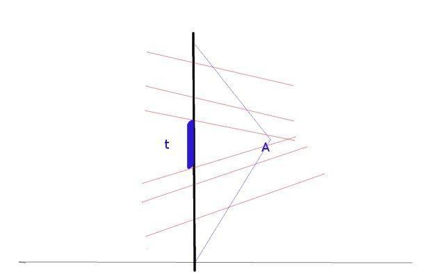

I kind of get it.. Can you further explain how the simultaneity "compensates" for the other person's clock running slow?
Look at the beautiful(!) Minkowski diagram attached (least I hope it's attached - never done this before...).
That big black bar up the middle is the stationary twin's worldline. The up axis is time. The horizontal line at the bottom is a line of simultaneity in the stationary twin's frame. All horizontal lines, all lines parallel to it, are also lines of simultaneity for this twin. Any two points parallel to the x-axis represents two events at the same time, according to stationary twin.
That faint bluish line that goes to the right then goes to the left - that's the moving twin's world line. He changes frame at space-time point A.
Those faint reddish angled lines - they are the lines of simultaneity for the moving twin. THe lower three are lines for the outward going frame, the upper three lines for the inward bound frame. You can add more - as long as they're parallel.
Look at the red lines just above and just below point A. From moving twin's point of view, there's little time between them, they're just a click away. But from stationary twin's point of view, there's a long time between them. Sure, during outward journey, moving twin thinks stationary twin's clock ticks slower; suring, during inward journey, moving twin thinks stationary twin's clock ticks slower. But he mustn't calculate total ticks of stationary twins' clock by simply adding up the number of ticks during the two phases of the journey - that would miss out all the ticks of the clock of stationary twin's clock during t.
All that extra time at t on stationary twins worldline more than makes up for the effects of time dilation. This qualitative explanation should be enough to see *how* it's possible - it's not enough to show that it more than compensates - for that, we'll need to start working through the actual formula
