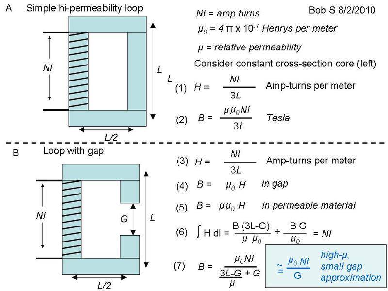

I have attached a thumbnail with the important equations for designing an electromagnet (solenoid) with (second figure) and without (first figure) an air gap. The air gap can be either inside or outside the coil, as long as the geometry of the iron (ferrite) is unchanged. Note that for the elecromagnet (solenoid) with an air gap, as the air gap gets shorter, the magnetic field field gets higher. Please review.
If you provide a very detailed description of what you want to do, I can provide more guidance. Do you want the magnetic field in a magnetic material or in air? How big a volume of magnetic field do you need? Is this an ac (pulsed) or dc electromagnet?
Bob S

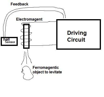

What I am trying to do with this electromagnet is to levitate objects.
The hall sensor (which am still to learn) will sense the distance of the object, and accordingly send feed back signal so as to lower or raise the power of electromagent, so as to keep the object suspended.
So, the electromagnet I am going to need is
1. Powerful
2. Continuous operation
3. Air gap
< you may know more :)>

For 3 amps max, the best choice of enamel-coated copper wire is 16 Ga.; 3.7 amps current carrying capacity, and 4.09 ohms per 1000 ft. For 24 volts, 3 amps, the length of wire should be about [STRIKE]700[/STRIKE] 2000 feet (8 ohms). You can add a ferrite rod to the solenoid to get perhaps a factor of two in magnetic field. An iron rod is too slow (eddy currents). You will not be able to get 72 watts out of the coil if you run it continuously (it will run too hot); you may have to run it 1 minute on, 10 minutes off. Maybe using forced air cooling will be sufficient to cool 72 watts continuously.
A Hall effect magnetic field pickup is probably too slow to respond to the movement of the ferromagnetic object. You might consider photodetectors to detect the elevation of the object. You will also need a fast amplifier to control the solenoid current (preferred to voltage control).

Based on my earlier post with a thumbnail analysis of a coil with a gap, the formulas indicate a hi-mu core in the solenoid will add about a factor of two to the external magnetic field. Note that the on-axis field drops off very fast below the end of the solenoid. This means that as the ferrite object gets closer to the solenoid, the attraction force gets stronger very fast. So if the magnetic field is constant, the vertical position of the ferrite object is unstable. You can overcome this with fast negative feedback from your vertical position monitors

Just a little chime in, when you use your sensor to detect the distance to the object make sure that you use a "Schmidt Trigger" to simplify your circuit. A schmidth trigger is an Op-Amp IC that 'swtches on' and 'switches off' more realistically, rather than oscillating a certain point.
Ex: to heat a room a schmidt trigger would turn on the heater when the room dropped below 60, but wouldn't turn the heater off till the room rose above 65. So the heater is not constantly being switched on and off.
Good luck on your electromagnet by the way. Send me a message if you need any help on your control theory. I actually had to design a system exactly like you are now, but the sensor/reaction side, not the magnetic side. =)
