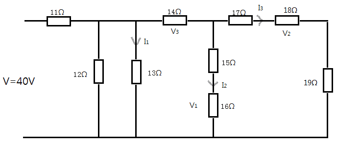

Can anybody help me solve this circuit?I want to find V1, V2, V3, I1, I2, I3.Power supply is 40V.

it's not very difficult to work with.
Please show part of your soln or some views.
you may first find V2.
Well,I don't know what to do at all.I hv found the total resistance,15.975 Ω ,and total current,2.504A.Is it correct?What to do next?Step by step if possible...

Those are close to the values I got: 16.265 ohms and 2.459 amps.
I would next find the voltage across the 11 ohm resistor.
From there you can determine the voltage drops across the 3 legs of your circuit, which will lead you immediately to I1.
And although they don't ask for it, you should then find the current through the 12 ohm resistor.
Knowing the currents through the 11, 12, & 13 ohm resistors will yield the current through the 14 ohm resistor. That will give you V3.

I don't think the equivalent resistance is 15.975 but 16.265
Sorry, I made a typing error.
You may first find "V3", by calculating equivalent resistance of the very right part.
then you may find V3 by the ratio of resistance
