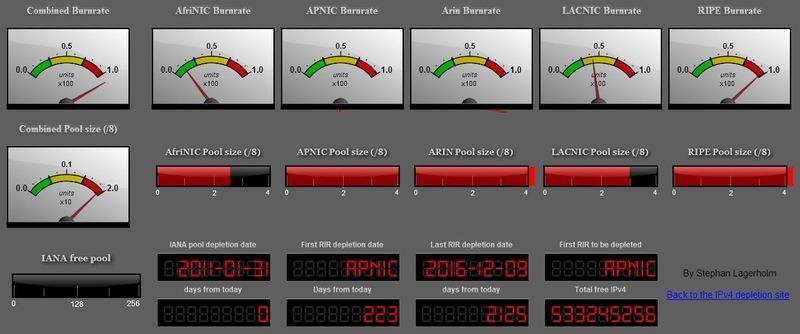

News story dated today, following my line of thought in my last post, surprise, surprise, some new facts first, see Stephan Lagerholm's chart (thumbnail) from the article below.
I didn't know there were five Regional Internet Registries (RIRs), but I do now.
Here's what we know will happen in the short term: There are 5 RIRs (Regional Internet Registries) for different parts of the world -- AfriNIC, APNIC, ARIN, LACNIC, and the RIPE NCC. These organizations get address blocks from the IANA and dole them out to ISPs and other entities in their regions based on their own policies.
