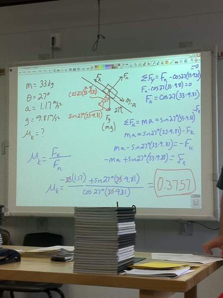

A 25 kg box slides down a 26 degree ramp with an acceleration of 1.32 m/s2.
The acceleration of gravity is 9.81 m/s2
Find the coefficient of kinetic friction between the box and the ramp.
mass = m = 25 kg
angle = (theta) = 26 degrees
acceleration = a = 1.32 m/s2
gravity = Fg = 9.81 m/s2
coefficient of kinetic friction = Mk = Fk/Fn
Fk = resistance, friction? Force opposite Mass*Acceleration.
Fn = perpendicular to the object's motion, upward
Fµ = Fn - COS26(I don't know...)
Attached is a pic of my teacher's process for solving the same problem, only with different values.
I'm clueless. Teacher said this is the toughest of the 14 problems that are due in 6 hours, so I thought I might seek assistance in learning how to do it. Please and thanks. :)

The force of kinetic friction is proportional to the normal force Fn, and its acts along the slope in opposite direction as the body moves. Fn, the normal force is the component of mg which is perpendicular to the slope,
Fn=mgcos(theta).
Fk=μ mg cos(theta).
The component of mg which is parallel with the slope is
Fp=mg sin(theta),
and it points down the slope. The force of kinetic friction points in the opposite direction. The resultant of these forces will accelerate the body down the slope
ma=mg sin(theta)-μ mg cos(theta).
Given m, a, theta, g, find μ.

Here, what exactly is "μ"? What does it mean?
It is the coefficient of friction. You used the notation Mk.
