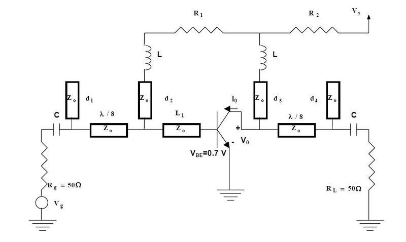

Hi guys,
I am trying to find a way to calculate biasing network for the attached circuit.
Basically I need to find R1 and R2 values for operating point of I0 = 10mA and V0 = 10V and Vs = 16V.
DC current gain is assumed to be hFE=80.
How do you calculate R1 and R2 based on these info? Please let me know.
Thanks in advance!
You know the collector current Io so you can work out the base current from Hfe.
So, this total current (Io + Ib) passes through R2 and you know the voltage across R2 (16 - 10) so you can work out R2.
Then, you know the voltage across R1 (10 -0.7) and you know the current flowing in it (Ib) so you can work out the value of this resistor.
