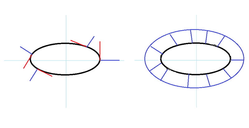

OK, here are some diagrams:
On the left is an ellipse centered about the origin. If we parametrize it, then for each point on the ellipse, we have a tangent vector (in red). This is just a non-zero vector which lies in the tangent line to the ellipse. In blue, we have constructed segments of length r perpendicular to the red vectors, pointing away from the inside of the ellipse.
On the right, the curve in blue is the resulting curve. This is the curve parametrized by g(t), and is "equidistant" of distance r from the ellipse.

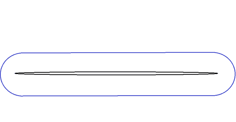

It's actually now obvious that this curve is NOT an ellipse, unless the original ellipse happened to be a circle. Here's why:
Suppose you take a very wide, very thin ellipse, which is very close to just being a line. Then near the rightmost and leftmost points of the ellipse, a curve which is equidistant from the ellipse will look like a semicircle. However, near the middle of the curve, it's almost completely flat:
Clearly this could not be an ellipse!
