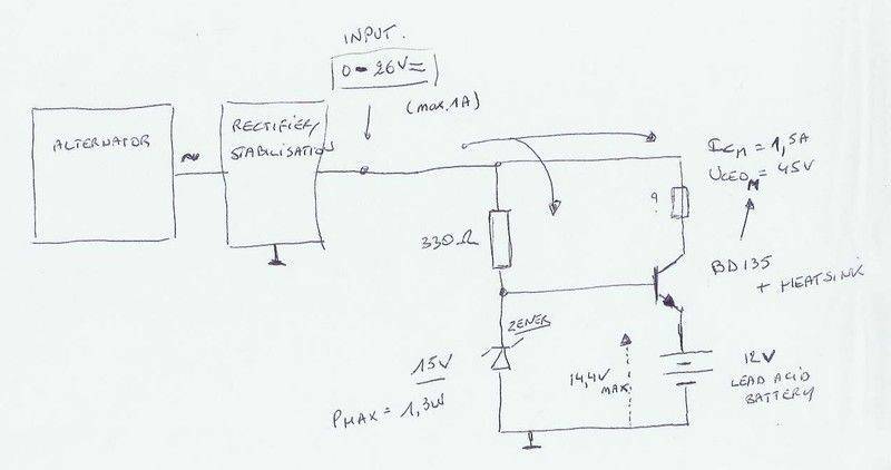

Hi,
I'm trying to make a voltage limiter for my kid's motorcycle. The engine has been replaced. It came with a different alternator. And the voltages are way too high now.
The rectified output varies between 15 and 26v DC. I'm trying to design a circuit which provides an output of max. 14,4 V for charging the lead acid battery.
The idea is to dissipate all the excess power over a transistor ( + heatsink ) while limiting the output voltage to 14,4V using a 15V zener diode to set the transistor correctly.
Please feel free to check the drawing and provide me with comments/suggestions.
Optional; would a resistor for limiting the current be required? (Rc)
Many thanks,
NivaOne

I think you may have calculated your wattages incorrectly.
26V - 5V = 21V ==> 21V = 330ohms * I ==> I = .0636A
P = I^2 * R ==> .0636^2 * 330 = 1.335W (resistor wattage)
P = IE ==> 21V * .0636 = 1.335W (Zener wattage)That is, the current flows through the Resistor AND the Zener and for all intents and purposes, both devices combine to drop the 21V. While this changes the device's power ratings, it does not affect your voltage regulator's fundamental design.
Next, the BD135 has a maximum collector current of 1.5A, a rating I find woefully low for Lead-Acid battery charging. Additionally the BD135 has a total device power dissipation of only Ta = 1.25W and Tc = 12.5W, again, ratings I find woefully low for Lead-Acid battery charging (<1A).
Transistors really are not my specialty, but it would appear to me that you have a constant emitter-base voltage of 5V, and with no current limiting shown, should place the BD135 in full conduction all the time (effectively turning it into a low value, heat dependent resistor).
So, no, I don't think your circuit will do the trick.
Now, back to solving your problem. Is it possible your new motor/alternator is designed to operate with a headlamp in series with the battery? Assuming a 100W bulb at a nominal 12V we would find:
100W/12V = 8.33A
12V = 8.33 * R = 1.44ohms
If we assume the resistance of the bulb is 1.44ohms, and the nominal voltage of the battery is 12V then:
12V + 12V = 24 ==> 26V -24V = 2V
The 2V will be "clamped" by some combination of the Lamp and the Battery with a current limit supplied by the 1.44ohm headlamp as follows:
26V = 1.44 I = 18.05A
This would mean that your headlamp would act as a resistive current/voltage regulator for your charging system. I would suggest you give this approach a try prior to ordering any components for your circuit.

That circuit would give 14.4 volts as you describe, but you really need a current limiter to initially charge a battery and then a voltage limiter to cut off the charging when the battery is fully charged. That circuit will try to give 14.4 volts out, even into a flat battery. This may destroy the transistor or blow a fuse.
If you go to Google and click on "images" at the top, then search for "car battery charger", you will see just how complex a battery charger has to be to work properly.
This is not a trivial project and motor bike batteries are expensive, so you really need to take the bike to an auto electrician to get it properly diagnosed and repaired.

Hi Fish,
Can you please have a look at your calculations again? I'm wondering where the 5V came from, I assume that you should have used 15V instead (26-15 = 11V)
regards
NivaOne
I assume you are talking about my second post and this equation:
The 5V is from your Zener. Your resistor drops all of the voltage except the 5V your zener drops. So, @ 26V, 21V is dropped across the resistor and 5V is dropped across your zener. (I mis-calculated the zener wattage in my previous post).
The Zener is 15 volts. This is mentioned in the text and also on the diagram, although in the diagram the 1 is more like an up-arrow symbol.
WOW, ok, I really did miss the zener being 15V. I assumed the ^ was just a spurious mark. MY BAD.
