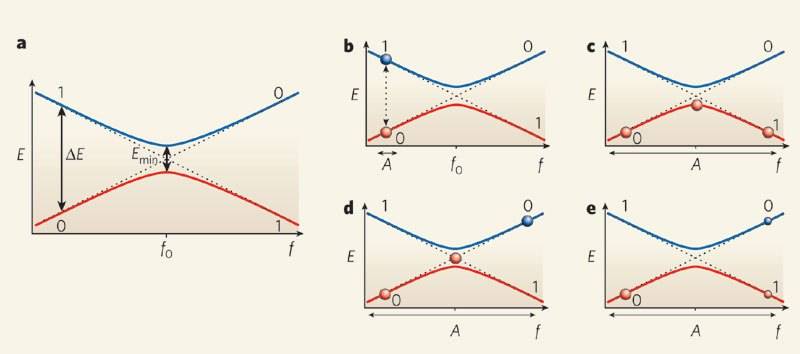

More specifically, consider a Hamiltonian with a changeable parameter a. When changing a, the ground state of the system will change. In some cases, one phase crossovers to another, like in other cases, there's a phase transition. What factor determines the difference? Actually I am now working on a specific model, the Dicke model. And I want to consider the above question in this and related model. So before that, I want some general guidances about the question to get to the point quicker. Thx.
Are you talking about where there is an avoided energy level crossing, due to off-diagonal terms in the Hamiltonian?
The theory is covered in the first 4 pages of a paper by Rubbmark et al.:
Phys. Rev. A 23, 3107–3117 (1981): "Dynamical effects at avoided level crossings: A study of the Landau-Zener effect using Rydberg atoms"
At the risk of oversimplifying things, it is determined by the rate at which a is changed. For a fast da/dt, the system will cross over; for a slow da/dt, it does not cross over.

I agree with Redbelly98 that it's about energy level crossing or avoiding. Crossing corresponds to a transition, avoiding to a crossover. The avoiding, in many cases, comes from the second-order perturbation, which mixes the original two “near-energy” state and opens a gap. When the mixing is forbidden, a transition happens. There're several ways to forbid it. The most common factor is that the original two states are of different symmetries. This kind of transition is continuous one. Another factor may be topological index, which I have only heard about and know little. Thanks a lot.
