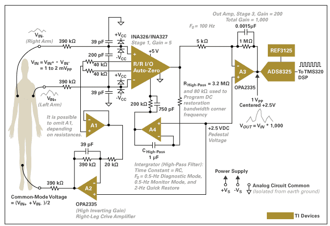

I attached a circuit design from Texas Instrument for ECG monitor amplifier and filter circuit, the last stage of the circuit Op AMP A3 it is used to make a gain of 200 and to shift the voltage 2.5v in order to allow the signal to be in the range of the ADC.
But the last stage will add 2.5 volts to the signal then multiply it by the gain 200 right?
Do i have to make another OP AMP to make the addition of 2.5 after the signal amplified by 200, or this circuit works as it is demonstrated in the daigram?
