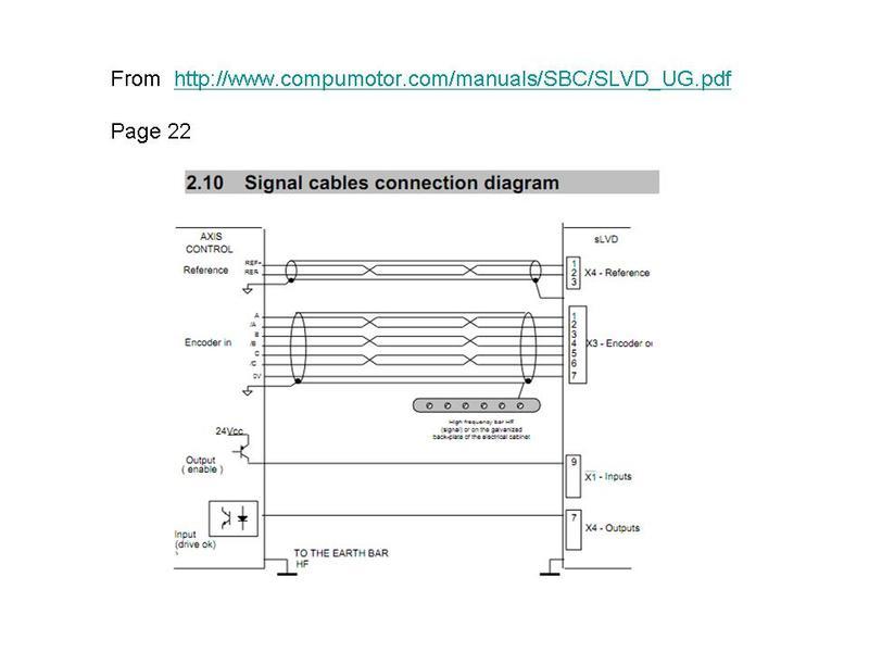

What I am doing: I am interfacing between a Quanser Q4 real time control and DAQ card and a Parker SLVD7N motor controller. The Q4 card has 0-5V DIO and the SLVD7N has 0-24V logic.
I do not know if the SLVD7N is sourcing as I cannot find the relevant information in the manual. Is there any way to test? If it is sourcing would this mean that if the DI is not dragged down it would return to 24V?
Again, I don't know how much current needs to be supplied to activate push the DI high. I cannot find it on the manual. However I can test this as I have access to a good power supply (with current and voltage control) and a good multimeter.

You can find a copy of thr Parker sLVD manual at
http://www.compumotor.com/manuals/SBC/SLVD_UG.pdf
Read it.
The two attached thumbnails show the a) electrical connection on page 22 (it is a pnp collector output), and b) the logic levels on page 87 (0< 3 volts = logic 0, and 15 < 30 volts = logic 1).
You will need to supply an external 24 volt source for the pnp transistor. I recommend a 1k pulldown on the pnp collector.
Read the manual.
[added] You still need to consider whether you want an inverting or non-inverting driver.
