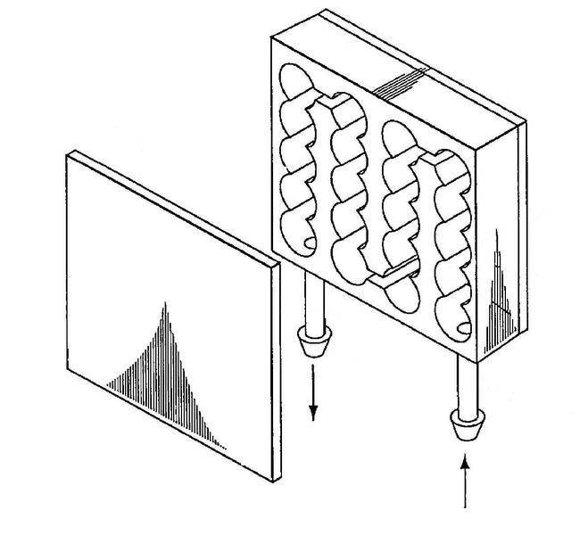

I am currently working on a project that cools water moving through a chilled aluminum block. I am not familiar with the math/physics involved and would like some direction or recommendations. My project is currently setup so that I suction 32oz of 70 degree F water out of tank1 and pump it through a chilled aluminum water block into tank2. I am aiming to get the water coming out of the chilled water block to 33 degrees F. I am trying to figure out what calculation I would use to calculate how many BTUs need to be removed from the water to chill it to my desired temperature for the whole 32oz. The water is flowing at a rate of 8oz every 42 seconds. If there is anyone that may be able to help me with some calculations I would appreciate it.

Thanks for the information. I am using a Thermo Electric Cooling module with the cold side attched to an aluminum water block and the hot side attched to a finned heat sink with and fan. I want to see if there is a calculation or formula to figure out exactly what I need to have the TEC cold temperature set to in order to meet my requirements as stated above. I have been experimenting with different voltages and temps but I can't seem to figure out a formula to predict what will happen when I change the variables.

Hey Frank,
Now that you know the thermodynamics, i.e. how to calculate Q, the next step is the heat transfer, i.e. how to calculate how big a block you need, and at what temperature. For this, it would be helpful to know a little more about how you will feed the water through the aluminum block: i.e. how many passages, the shape of the passages (i.e. circular), any dimensions you have.
Hey thopsy,
I have made a couple differnt blocks. I am able to cast aluminum so I can make any size. I was just shooting in the dark trying to figure out what might work. I also have several different TEC modules with ratings of 70watts, 168 watts, 226 watts and 400 watts.
The first block I made was a 3" square, 1" thick. The channels were drilled out using 1/2" bit. The bottom and top are about 1/8" thick. I attached a rough sketch of what it looked like.
The second block I made consists of a 1/8" stainless steel tubing coiled inside a 2 3/8" square, 1 1/2" high aluminum block. I figured the stainless steel tubing would make the water flow faster and smoother to help the heat transfer.
If you have any recomendations for a block please let know as I can fabricate anything.
Thanks,
Frank
thopsy said:
Hey Frank,
Thanks for the sketch. It's quite difficult to calculate the heat transfer for a complex geometry like this, but you can do a simplified calculation.
In general smooth flow has worse heat transfer. The rough profile caused from the drill holes will help to create turbulence which increases the heat transfer. Also the metal-to-metal contact from steel-to-aluminum will reduce the heat transfer a lot. I think the drilled aluminum is the best idea.
I'm swamped at the moment, so will have to get back to you in a day or two.
