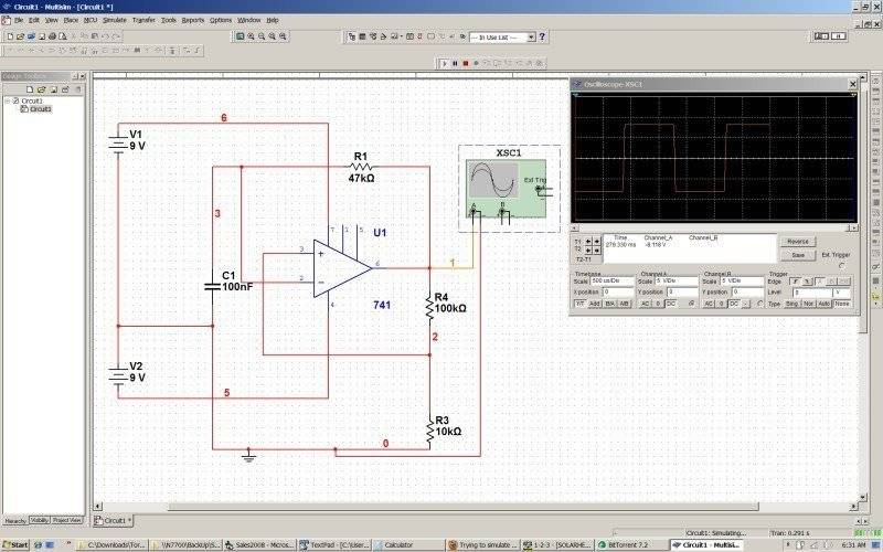

For my extra credit project i am building a simple square wave osc i am trying to simulate the schematics in Multism, a program i just learned today.
Here are the original schematics:
more info on the circuit is found http://www.circuitstoday.com/square-wave-generator-using-ua-741"
These are my schematics suppositly replicatinmg the ones above. The ocilliscope just shoots up then remains blank.
Thanks

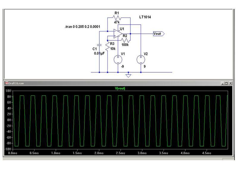

omonoid, I just created and ran your circuit and get a beautiful square wave with a frequency of about 210 Hz. I think if you reverse your inputs it will work.
You build the circuit yet to proof it works? I agree with Bob S that you need to put two 9V battery and put the middle to ground. In your simulation, you don't have a ground reference anywhere. Even if you build the circuit as in the simulation, it won't work. It is different from you drawing with two battery.
I meant to say I created it in SPICE and I did use two 9 V supplies. Afterward I changed the circuit as little as possible to work off of one supply. See attached.
Took me a few, LOL. You DO need two batteries, give this a try.

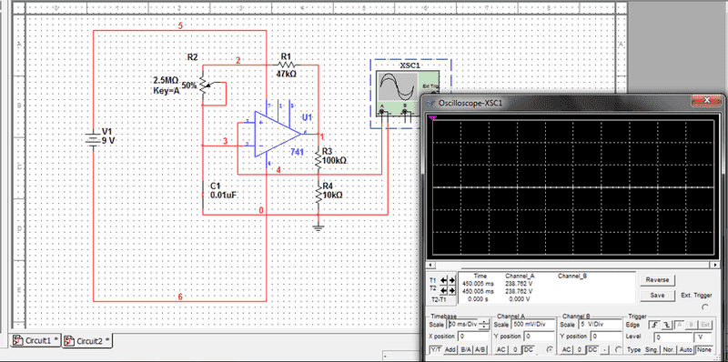

thanks for all the feed back. I would like my final product to have a pot to vary the frequency and one to vary the amplitude. Would i just preplace one of the resistors with a pot to make the freq vary? Also for amplitude would i just wire in a pot before the output?
First try the extra resistor shown in the previous post to see if you get oscillation.
If you do, then R1 and C control the frequency so it is easiest to make R1 variable.
The voltage at the non inverting input sets the amplitude of the square wave, however adjusting it may cause loss of oscillation.
You could just put a pot (maybe 10 K) from the output of the opamp to ground and take the output from the moving contact and ground. Try simulating it.

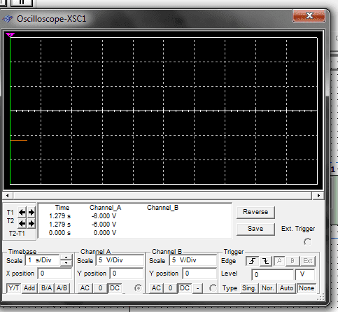

ugh i must suck at simulating. My result was a flat line on the oscillospope
I also noticed its a LM124 op amp. I only have a 741
here is my schemtaics for the simulation
I get delays of a second or so before it starts oscillating.
Can you set your time so that you watch it for 5 seconds?
The actual opamp probably doesn't matter for this simulation.
Hmm i started at the oscope for like a minute and it was a flat line

I mean no disrespect, but I downloaded multisim, leaned it and made it work in 2 hours using your OP schematic. I posted the screen shot. Exactly how are you having difficulty with the notion the 741 requires a dual polarity supply when it was part of your OP? Anyway, I hope you get your EC; I did my part for fun, LOL.

Also i threw in a 10k pot in place of your R4 so i can adjust the frequency and it works.
Is there a way of calculating for the right size pot to use? i want it to be able to go from around 100 HZ to 2.5 MHz. The built in oscope doesn't show frequency

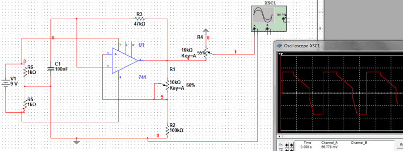

Of course that's true but, if you use a single power supply, your biasing has to be modified accordingly. The amplifier amplifies the Difference between - and + inputs so they need to be more or less equal, if the gain is 10,000X. Notice that the 'working' version (above) has its + input biased to half rail volts, which allows it to work with one power supply.
Edit. In the original circuit, if using a single PSU, when the -input goes up, the output will go down and the +input can remain below -input, even when the capacitor has stabilised - you're relying on the op amp functioning properly with inputs right next to the ground and -in can still be higher than +in (not being properly defined). The idea is to operate an op amp with its inputs around half rail so that either can be made higher or lower than the other, in a well defined way.
I tried incorperating a voltage divider on a 9v so i would have a + and - 4.5v going to the opamp. For some reason the oscope displayed a odd shaped non square wave. What am i doing wrong?
