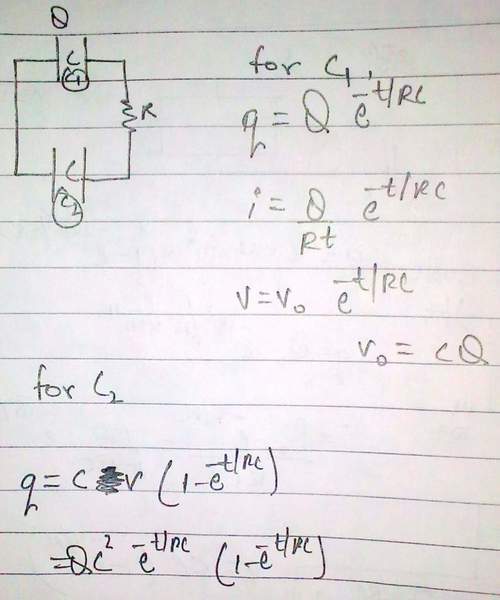

1. The problem statement and my attempt
<pic>
Its not the correct answer.
answer is: Q/2(1 - e-2t/RC)

Use conservation of charge; there's nowhere for it to escape to!
The sum of the voltages across R and C2 is equal to the voltage of the first capacitor. Q1/C1 =I*R +Q2/C2. As the charge is conserved, Q1+Q2=Qo=const, and I=dQ2/dt=-dQ1/dt, so you have the differential equation (Qo-Q2)C1+Q2/C2+RdQ2/dt=0 with the initial condition Q2(0)=0.
