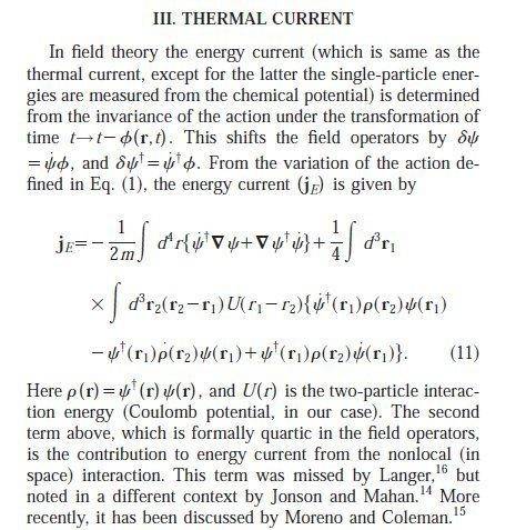

By the way, I have a paper which discusses this topic a little, but it expresses the energy current as an integral, which is not what I am looking for. See the attachment.
daudaudaudau said:
Hi Tom. No I am in fact interested in the energy current. I am just mentioning the probability current in order to explain that I am looking for the energy equivalent of the probability current. But it is true that what I am doing is completely non-relativistic. I need this energy current for calculating the thermal conductivity of a substance.
The formula in the attachment is not correct since the j given there has no longer an r dependence. You get a correct formula by applying the generalities of http://en.wikipedia.org/wiki/Noether_theorem#Field-theoretic_derivation to the time translation symmetry of your system. (Weinberg is not appropriate in your case since your system is nonrelativistic.)
If you want to you can see the full article in this attachment. Also in formula (2) he defines a current which has no r-dependence. I think the article looks pretty legitimate, so it would be strange if it had large errors.
That current is just a number, because the fields under the integral are solutions of the field equations. It loses any r or t dependence, since the space dependence is all integrated wrt, while the t dependence is lost because j is a conserved current. jt_1)=j(t_2).

How can such a current satisfy the continuity equation, which characterises the fact that the total energy is conserved?
It is by no means clear why they call it a 'current' - it's integrated over x. For a conserved current one would expect a local conservation law, a continuity equation for charge and current density.
It is dangerous to rely on formulas written elsewhere without being able to check them yourself. Being published does not imply being correct.
The notation in the paper is _very_ sloppy. You can check this already by looking at his formula (2) for the charge current, specialize to the case of zero external vector potential, and comparing it with the correct expression that you wrote down in #10 (apart perhaps from the factor).
So you need to learn the tools of the trade that enable you to apply Noether's theorem yourself!
