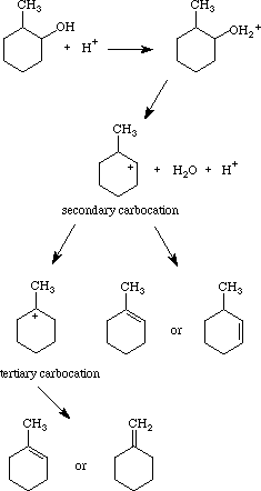

\alpha-terpineol produces four different alkene products (including imonene) when it is dehydrated via E1 mechanism.
On the other hand, 2-methylcyclohexanol produces two different alkenes through E1 mechanism.
Which of these product do you think would be formed in the greatest amount? I personally think 2-methylcyclohexanol will be formed in larger amount. Here's my explanation:2-methylcyclohexanol has more product since alpha-terpineol might have more side reactions during dehydrations. (carbocation+alcohol --> ether / carbocation+alkene --> plymeric alkene)
I am not completely sure. What do you think? Alpha-terpineol or 2-methylcyclohexanol?

Am I misunderstanding the question or are you: it sounds like it's asking, "Which of the alkene products of the dehydration of 2-methylcyclohexanol would be formed in the largest proportion?"
Carbocation + alcohol -(acid)-> ether? possible..
carbocation + alkene -(acid)-> polymeric alkene? maybe...
I don't think either of those two proposed reactions are relevant here. If I were you, I'd consider the thermodynamic stabilities of all the alkene products to determine which one is formed in greatest quantity.

They wre just an example of the side reactions that could occur. Those reactions might disturb the yield. Thank you for your advice. :)
