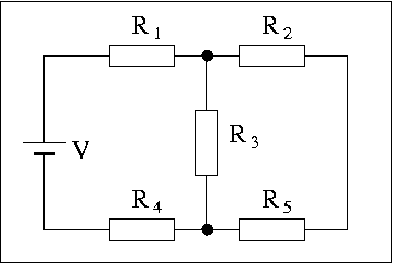

Consider the electric circuit shown in the figure. Assume that V = 21.7 V, R1 = R2 = R3 = R4 = R5 = 6.00 Ohm.
Part 1) What is the equivalent resistance of the circuit?
Part 2) what is the electric current flowing through R4?
Series and parallel equations
I don't really know where to even start on this at all ?

Finding the equivalent resistance of the entire circuit would be a good place to start.
Any electrical charge which flows through the battery can follow one of two paths on its way back to the battery. What are those two paths?
I think I might be able to get the second question. But I need help on the first part. finding the equivalence, I keep trying but not the right answer.
Can you show an attempt?
I repeat: What are those two paths?
Ok I got the first part. It was 16 Ohm. I realized I was using the wrong eq's. Now for the second part...
@SammyS .. I don't really know what you mean?
You have the equivalent resistance (your 16 Ohms), so what is the total current that the battery is delivering?

i have a question about this problem .. (i know it's old but hey)
if i have the total current.. which in this case is 1.35625A, how do you approach getting the current across just R4?
can you think of it the same way as you would if they were capacitors? i mean like break it down .. resistors in series have the same current on it while resistors in parallel have the same voltage. so that being said, combinations of R2, R3, and R5 are in series with combos of R1 and R4.
so I235=I5=I4 no? so wouldn't I4 just be 1/3 of the total I ?

What do you mean by total current? Where is that total current flowing?
ummm total current flowing throughout the whole entire circuit, right ..
the sum of the current that flows thought each resistor and everything

If you look at the diagram, you will see that the current through R4 is exactly the same as the current through the battery. You have already determined that answer.

is that because you can start at the battery and travel across is towards its negative side and since nothing is before R4 that makes it the same current?
Just like water in river current. Amount of water remains the same.
In electricity it is just the flows of electrons.
yea but .. isn't the current different in other resistors besides R4?
If it branches to 2 different tributaries,then sum of them equal to main flow.
At the end of tributaries where they are rejoined to form main river, the amount of flow as the water enter will be equal to the amount when they rejoin.

Sure. Where do you think the current that passes from the + side to the - side R4 goes next (rhetorical question)?
