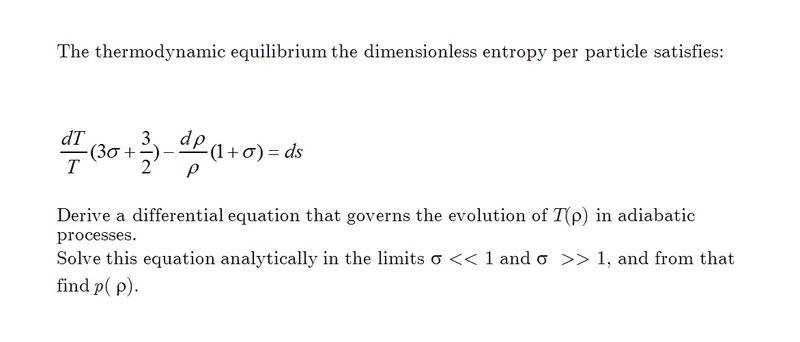

Hello,
I'm trying to derive a differential equation as requested in the attached exercise (thermal1.jpg).

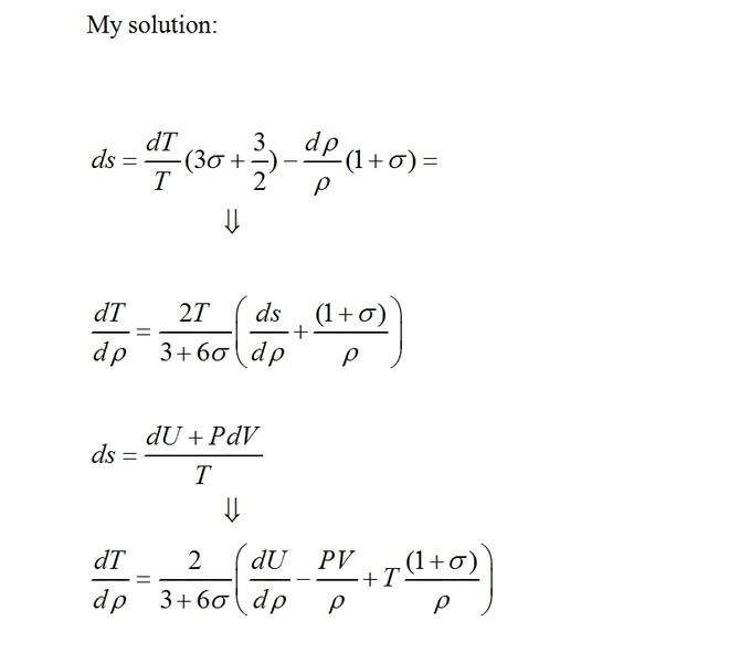

I'm not quite sure my solution is the right answer (my_solution1.jpg).
How do I get rid of the energy dU ?
Thnks

well in an adiabatic processes dQ = 0 so ds = 0 giving you quite a simple derivation of the differential equation
OK, It sure gives a simple derivation of the differential equation, but what is the physical explanation for that?
Thanks
it most generally means that it is a reversible process
