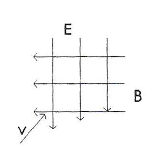

An electron moves through a region of crossed electric and magnetic fields. The electric field E = 1000 V/m and is directed straight down. The magnetic field B = 0.4 T and is directed to the left. For what velocity V of the electron into the paper will the electric force exactly cancel the magnetic force?
Please help me solve this problem because I have no idea where to start.
I don't have an attempt because I don't know where to start solving the problem.
Picture an electron moving to the right, the magnetic field is pointing down the page, therefore the magnetic force is out of the page and is equal to qvB. Then to cancel this, the electric field must also be out of the page to produce a force into the page equal to qE. Then we have qvB = qE, then what must v be equal to? And then what must K.E. be equal to?
This reasoning will solve both problems.

i just tried solving the two problems and qvb=qE so then I set the first problem up like this:
[tex]1.6\times 10^{-19 } \textup{ C }\times V \times 8^{-3}\textup{ T} = 1.6\times 10^{-19} \textup{ C}\times 4000\textup{ V/m}[/tex]
I also have a question about this... Don't we have to add the forces on the electron from the electrical field and the magnetic field? In other words, [tex]F = F_{electrical} + F_{magnetic}[/tex]

This is exactly what we are doing
[tex]\vec F_{net} = \vec 0 = \vec F_E + \vec F_B = q \vec E - q \vec v \times \vec B[/tex]
then, since the forces are both lie along the same line, we evaluate the magnitudes of the forces as
[tex]qE - qvB = 0[/tex]
