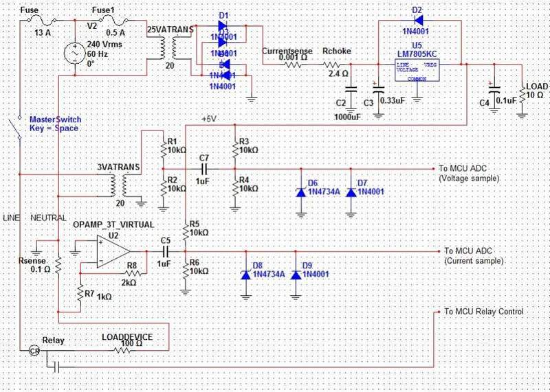

Now the problem was trailed to the sense resistor, 0.1 ohm at the neutral wire.
It is connected to an opamp for gaining purposes. Does it need another transformer before going to the gain stage? is there a short in the ground in the sense that the opamp ground and the neutral?
Are you making an AC to DC power source with PID feedback control out of curiosity? Try powering the Op-Amp's with a floating power source (use an isolating transformer between the mains and the normal power source) and remember that oscilloscopes are internally grounded too if you make measurements and they come out funny or cause problems.
If you somehow manage to put a 0.1R resistor in parallel with the circuit then you would expect an over current fault, but it should be in series on the neutral (to create a voltage proportional to the return current value to eventually modify the input duty cycle to move the output power closer to the users desired power, right?).
Perhaps if you posted the schematic you are trying to make, someone could give you some tips if there's any problems. At this point its hard to see whether the problem lies in your understanding of theory or a potential wiring error.
This is my schematic, the function of this circuit is to translate voltages and currents into DC levels to be read by a MCU.
It has a built in simple +5V power supply to supply components, and the voltage & current sensings circuitry. The opamp is powered by the built-in +5V and -5V converted and supplied by a charge pump DC-DC converter TC7660 (not drawn in schematic).
Once the oscilloscope is connected across the output of the opamp (for current sensing), the breaker trips.
