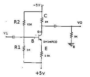

hi all i have some questions about a commen emmiter bjt amplifier circuit .
if i had this circuit :
and i want to find the ripple of voltage in outout :
i will use this equation :
[tex]V_{O(p-p)}=2I_{CQ} (R_L || R_C)[/tex]
but why i put[tex]R_L || R_C[/tex] not [tex]R_L || R_C + R_E[/tex] or how i conclude that this is the equivalent resistance at output .
is this connected with thevnin equivalent circuit at output if so !how.
and is it right that i can here in this problem put one power source (10v) without any change on answers.
thanks .
p.s: this isn't a homwork.

The input is the base, the output is the collector. What else could it be other than a common emitter? RL is in parallel with RC as far as and AC signal is concerned.

They call it common emitter because the emitter is common to both the input and output, that doesn't imply that the emitter must sit at ground.
By that do you mean the small signal(AC) component of the output?
but why i put
RL||RC
not
RL||RC+RE
You should really draw the small signal model of this amplifier and show us what you come up with, if you're doing that wrong this may the source of your confusion. On the other hand, if you're not drawing the small signal model that may be the source of your confusion.
After doing so it should be obvious that,
[tex]R_{out} = R_{c}//R_{L}[/tex]
yes this is what i mean.

yea exactly this is what i must do and like what i asked:
i find after googling about small signal model that i must at AC consider every capacitor as "short circuit" and also the power source so[tex]R_L[/tex] and[tex]R_C[/tex] have two commen point (one at C and one at GRD)so
[tex]R_{out} = R_{c}//R_{L}[/tex].
confusion solved thanks very much:
BTW. That is neither the output ripple nor is it the small signal output. It is an approximation to the maximum possible peak to peak output voltage assuming a mid point bias. That comes from a large signal analysis. Start by trying to understand the small signal analysis and basic bias point calculations first.
