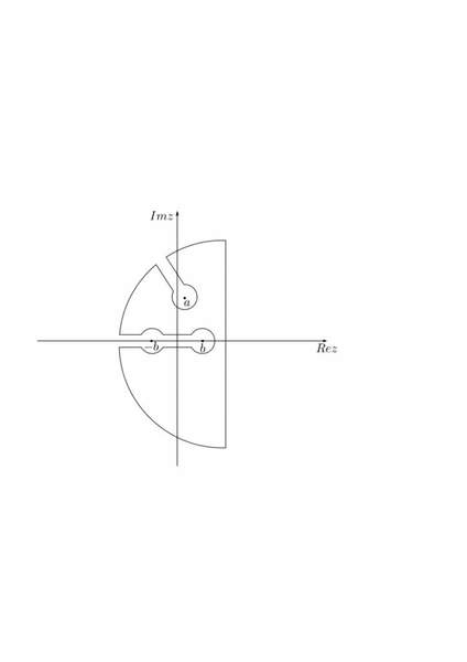

I want to perform the following integral which comes from inverting a Laplace transform:
[tex] \lim_{R\rightarrow\infty}\int_{\sigma -Ri}^{\sigma +Ri}\frac{e^{sx}}{\sqrt{s^{2}-a^{2}}}ds[/tex]
Would it be some kind of keyhole contour?
Mat
You need a semi-circle where the diameter is on the right (from your perspective) of the poles [tex]\pm a[/tex]. That's easier to work with.
I am aware of the Bromwhich contour for the Laplace transform. Do I need to cut to disks out at [itex]\pm a[/itex] to make a double keyhole if you like?
Also if a is complex do I need to do the same thing? What about a slightly function?
[tex] \lim_{R\rightarrow\infty}\int_{\sigma -Ri}^{\sigma +Ri}\frac{e^{sx}}{(s-b)\sqrt{s^{2}-a^{2}}}ds[/tex]
where b is real. Do I need the keyhole contour again?
This is the contour that you would usually use if there are any singularities on the real line but what is you singularities move? I have a value which moves from being completely real (hence the need for a keyhole contour shown to one being complex and I can just take a semi-circle.
Suggestions?
Mat

Surely if [itex]a[/itex] is complex then then I don't need all this fuss about a keyhole contour, I can just use a semi-circle.
I have done another contour which I think it should be, is this more like it?

I think the best approach here would be to use the keyhole contour, the integral in question is somewhat more complicated than the initial one I posted as I wanted to get a feel for the square root in the denominator.
If you wish to integrate it directly, then I think you need to use a dumb-bell contour around the branch points [itex]\pm a[/itex] enclosed inside a larger closed contour which includes the Bromwich path. These two contours then traverse an entirely analytic function so they are equal to one another and I think the dumb-bell contour is not too difficult to analyze. The reason I suggest that is because the Riemann surface for n'th roots of n'th degree polynomials are analytic outside the hull of polynomial zeros. I barely understand it myself for that matter. Tell you what, when I do that for the simple case I used above, I obtain:
[tex]\int_{1}^{-1}\frac{e^{r x}+e^{-{rx}}}{\sqrt{r^2-1}}dr[/tex]
and that integral can be written in terms of [itex]\text{BesselJ[0,ix]}[/itex]
however, I've not analyzed the remaining parts of the contour to justifiy equating that answer as the inverse transform.
I had a go at doing the integral myself and it reduces to an integral on the real line which I can't compute, can anyone lend a hand or spot where I have made a mistake?

Hey Hunt, the contour you used is definitely wrong if [tex]a[/tex] is complex. I know this because, the contour must have keyholes which have positive or negative imaginary parts (depending on where [tex]a[/tex] is located). However, on the contour that you used, the keyholes are located on the real axis. By the way, just to avoid confusion as to which [tex]a[/tex] we are talking about, forget about the new problem, I'm still looking at the pdf you attached.
To get the Bromwich contour, look at all the singularities of the function you are dealing with. Plot them on the complex plane. Then look for a the line which is greater than the real parts of all the singularities of the poles. It doesn't matter how far away this line is or how close as long as it is to the right of the poles. Then try to draw the fewest number of keyholes around the poles with the contour going in the counterclockwise direction. Remember this: If you are walking along the contour you must see the poles on your right hand side. Then use the Cauchy residue theorem like you did before.
Three words I'd like to add to the discussion: Cauchy... Residue... Theorem...
I thought I could just deal with [itex]a[/itex] in the normal way if it was complex, it isn't a branch point in any way, it's just a simple pole. Having taken you suggestion to heart, I sketched the contour which I think you mean. Is this the correct contour now? I have a feeling that the integral around the pole a will vanish but I will be left with contributions from the paths to and from the point?
OK, try this and I'll check numerically the integral you get with the convolution I got.
