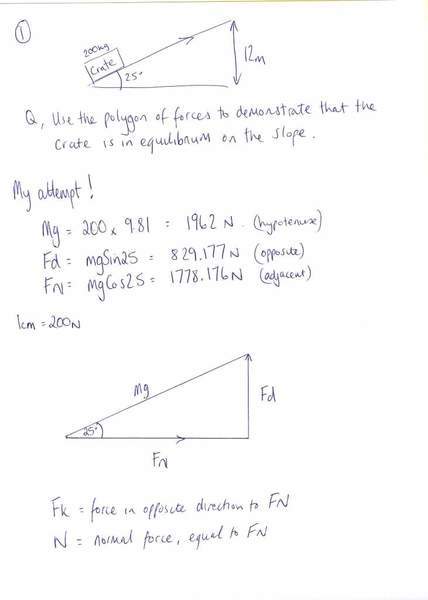

Use the polygon of forces to demonstrate that a 200 kg crate on a 25o incline is in equilibrium on the slope.
See attached

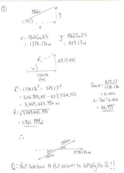

Please see attached for my attempt, I think I am in the right ball park, just need to know what seat to be in, i.e. how do I plot the answer to satisfy the question. Please help...
Thanks

You must draw the force polygon so that the forces show the correct magnitude and direction. For instance, how must the weight vector of the box be drawn?
Hi there, thanks for your reply, I know I need to draw a force triangle of some sort, but unsure how to do it with the information I have. Even then, is this a correct polygon of force??
Thanks
What direction is the weight force usually drawn?
