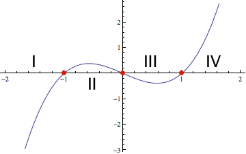

I've attached a picture to illustrate what Mark explained above. From the plot of f(x)=x^3-x, you can see that for all points in intervals II and IV, the graph is above the axis, and for all points in I and III, the graph is below the axis. To get from one region to another (at the red dots), the function has to cross the axis, so the endpoints of the intervals correspond to where x^3 - x = 0.
Thanks, the graph does make things all the working here clearer
