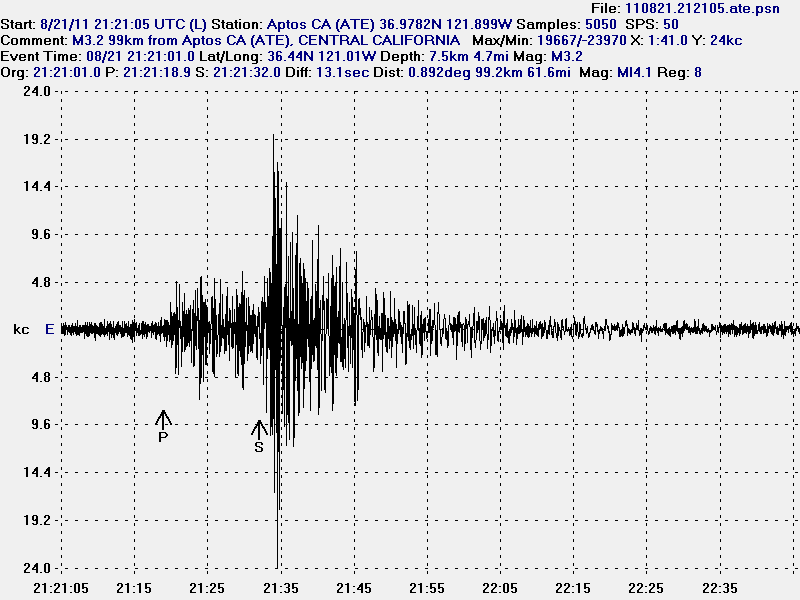

These days, its all done digitally, as in the system I run from home. Those calculations are done by the software once I place markers on the P and S wave arrivals on the seismogram.
here's an example from the software I use, this was recorded by a guy in California of a small event in Calif. You can see the P and S markers and in the bottom line of the upper text box you can see the info on the event as calculated by the software. Origin time P arrival; S arrival; S-P difference; distance in degrees and km(miles); magnitude etc

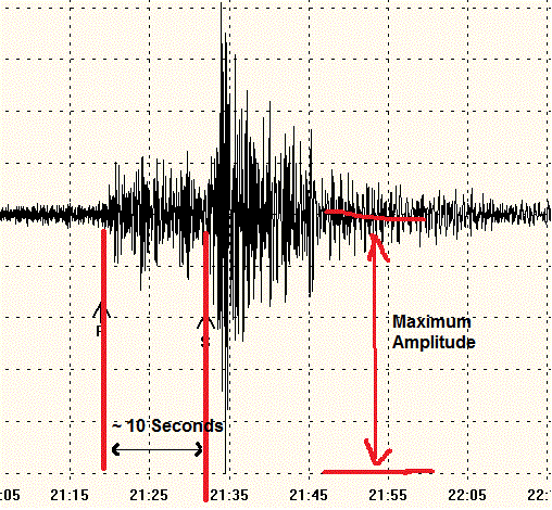

Lets look closer at the seismogram and nonogram to determine a magnitude
now these 2 images are unrelated ... they are just examples OK
the seismogram ... in the days of old , ink pens drew a trace on paper wrapped around a cylindrical drum that usually rotated once every 15 minutes.
( there are still a few around ---- my old one is used by a friend in Christchurch City in New Zealand where there has been a series of big quakes over
the last 12 months)
Calculating magnitude
Rule of thumb #1 ... measure the S wave - P wave and get that time in seconds
the example below ~ 10 sec multiply that by 8.5 to get the distance to the event.
(great for quakes under 500km away from the recorder)
So take 2 measurements from the seismogram
1) --- the S - P time = 10 sec.
2) --- the maximum amplitude of the P or S wave ( which ever is bigger) in example below the S wave. let's say its 35mm

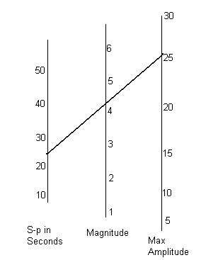

transfer those 2 measurements to the nonogram and read off the magnitude.
now the nonogram I have below is one I created for another thread on this forum
so ignore the different figures used. ALSO note this isn't the real one used by Richter. Its one I threw together as a quick example OK ...
so people could see a visual representation :)
you see 3 vertical scales left one is S-P time --- the middle one is Magnitude --- the right one is the max amplitude recorded on the seismogram
You draw a line between the left and right values and where is crosses the middle scale you read off the magnitude
In this example... the S-P was 25 seconds and the Max Amplitude of the trace was 25mm

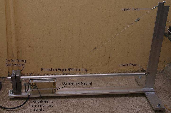

over the last month have just got a new sensor online and working
is what they call the "Lehman" style at the moment its period is ~ 10 seconds ( when measured undampened)
I'm having a bit of a struggle getting it to the 15 to 20 sec period that it should be capable of. it requires some really fine adjustments and lots of patience :)
There have been a few modifications since that pic , but it will give you a good idea
of the unit
