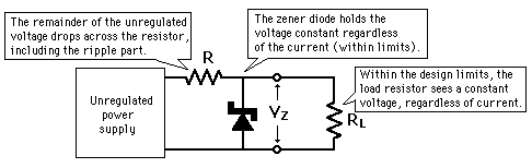

Cant we use a ZENER DIODE ?
Sure can.
Now you'll have to pick a Zener diode that can handle the current requirements. Here a calculator that will get you in the ball park.
http://hyperphysics.phy-astr.gsu.edu/hbase/electronic/zenereg.html#c1"
Thanks, guys. I'm definitely impressed with myself that I was able to get my brain to figure that out, as simple as it was.
However, you lost me with the zener diode. I completely understand the concept that the voltage may vary with load on the pump, however, I have no idea how I would go about designing the zener regulator.
In the diagram, is "unregulated power supply" my charger/adapter? Assuming so.
What's Vz? Is that my pump? If so, does that mean that the diode and the load resistor are just wired in parallel with the pump?
