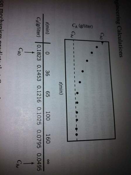

A chemical Reaction A-->B is carried out in a closed vessel. The following data are taken for the concentration of A, Ca (g/L), as a function of time, t(min), from the start of the reaction. A proposed reaction mechanism predicts that Ca and t should be related by the expression
ln (Ca-Cae)/(Ca0-Cae)=-kt
where k is the reaction rate constant
Do the data (see attached file) supports this prediction? If so, determine the value of k. (Use a semilog plot in your solution for this problem)
Can someone explain to me what using a semilog plot means? And, maybe give me a hint on how to start this problem please... Thank you!

A [2-D] semilog plot has a logarithmic scale for only one axis.
To start the problem, I would exponentiate to get rid of the logarithm. Re-arange to solve for CA, and determine if the function's initial value and the value it approaches agree with the plot.
You should know what the plot of [itex]f(t) = Ce^{-kt} + D[/itex] would look like.
Know that if k is positive, the term [itex]Ce^{-kt}[/itex] will approach zero as t becomes larger.
You should be able to indentify (in terms of C and D):
  • the value of this function when t = 0
  • the value it approaches as t becomes larger
