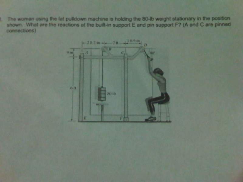

Please help Due in 2 hours. Statics machine equilibrium: reactions- too many unknowns
The woman using the lat pulldown machine is holding the 80-lb weight stationary in the position shown. What are the reactions at the built-in support E and pin support F? (A and C are pinned connections)
First, I isolated the pulleys and rope to find the components of the tension at D.
Dx=80cos60=40 lb
Dy=-40√3 lb
Then I set up my three equilibrium equations:
∑ME=0= -(80 lb)(13/6 ft) - (40√3 lb)(17/3 ft) - (40 lb)(27/4 ft) + ME + Fy(25/6 ft)
ME= (680√3)/3 +1330/3 + (25/6)Fy
∑Fx= 0 = Ex + Fx + (40 lb)
∑Fy= 0 = Ey + Fy - (80 lb) - (40√3 lb)
Right now, I have 3 equations and 5 unknowns, Ex, Ey, ME, Fx, and Fy.
I'm probably supposed to break it up into two systems, first just the top portion. But I'm not really sure how to proceed from here.
Thank you!
