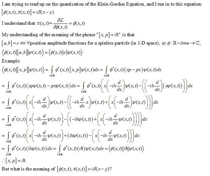

Hi, I have a basic question regarding the commuter brackets. Basically, what does the syntax mean?
I understand that in general, [a,b]=ab-ba, but I am confused as to how to make sense of that with fields. I am currently reading up on the quantization of the Klein-Gordon Equation, and I ran into such a problem. I attached a jpg file that has the rest (the book I got the equation from leaves out h-bars). Any help you can give will be most appreciated! Thanks.
I think there was a typo, it should have read: [itex][\phi(x,t),\pi(y,t)]=i\delta(x-y)[/itex]
This is the field commutation relations where one is "second quantizing" i.e. quantizing a field.
You can think of the classical [itex]\phi(x,t)[/itex] as a abstract displacement over time of a model system located at position x. Dual to that displacement is a canonical momentum [itex]\pi(x,t)[/itex]. You can think of the coordinates x (or y) here as a continuous index just as for an n dimensional system with [itex][q^k, p_j] = i\delta^k_j[/itex] has index j or k.
This comes from modeling say a bosonic field, in terms of an array of harmonic oscillators located at each point of space. Each harmonic oscillator has its own coordinate and momentum. The coordinate value for the harmonic oscillator at x is [itex]\phi(x)[/itex] and its momentum is [itex]\pi(x)[/itex]. You then have a field of classical systems which you then quantize to get a quantum field. Local coupling between these systems at each point allow them to propagate the field waves which when quantized become the bosons.
It is important to realize that the [tex]\phi(x,t)[/itex] here never was nor is a wave-function. It starts as a classical field (note it first appears in a classical Lagrangian) in a model which is quantized to yield the quantum field.[/tex]
Thank you! that helps.

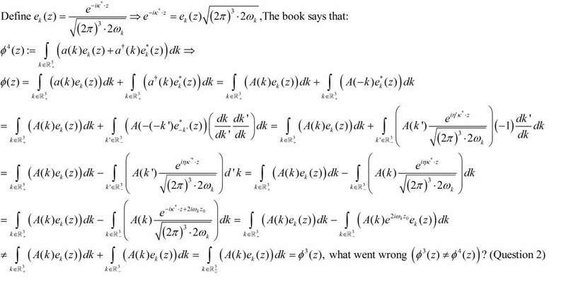

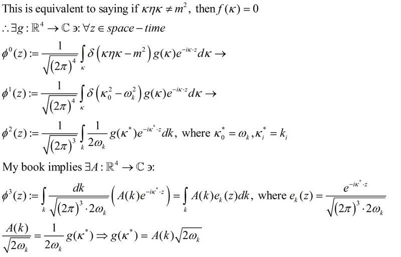

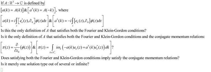

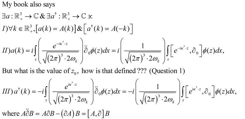

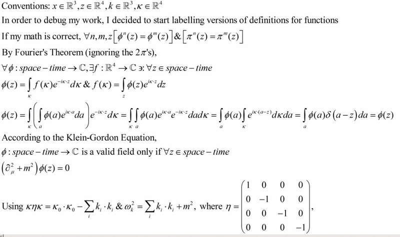

I am trying to understand the canonical quantization of the Klein-Gordon equation and I am quite mixed up. I have been going over the same equations for over a week now and getting nowhere. My main textbook is Quantum Field Theory: a Modern Introduction by Michio Kaku, but I have been scouring the web as well. Attached is my work. If anyone can help point out where I am going wrong, it will be MOST appreciated. Thanks.
I could only attach three images, so here are the other two...

Apparently my first three images didn't attach. woops.

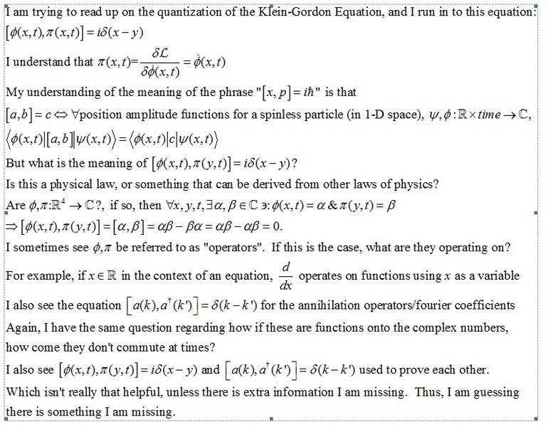

Thanks, I just ordered the book off of Amazon. Okay, I think I am comfortable with the mathematical derivation of the creation and annihilation operators. But I am still having problems understanding how both the position and momentum fields, and the creation and annihilation operators commute. I guess my question boils down to functionality. If all of these are functions onto the complex plane, how come their values don't commute? Attached are my questions in more explicit detail. Thanks.
