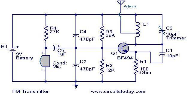

From my understand, electrical current is required to generate RF. In the picture below, only one end of the antenna is connected L1. If only one end of the antenna is connected, how can electrical current travel up the antenna to generate RF?
The antenna is long enough that it needs to be treated as a transmission line, and not a simple open circuit. Think of shaking a rope with the far end free (analogous to an open circuit at the far end of the antenna). Waves will travel down the rope. This is basically what happens with an antenna. EM waves travel down the antenna and the energy is radiated into space.
This circuit would operate at about 100 MHz and, at this frequency, one wavelength is about 3 meters. So, a quarter wave length is about 75 cm (29 inches).
If you put a 100 MHz sinewave at one end of a piece of wire that is 75 cm long, the voltage takes about 2.5 nS to reach the other end. While it is doing that, the input keeps changing, so the voltage at the end never catches up with the input voltage.
There is always a voltage difference between the ends of the antenna. The end is always 90 degrees out of phase with the input voltage
So, there is a current flowing between the two ends of the wire even though one end is open circuit. This current causes some of the input power to be radiated.
This seems alien to everything you have learned about DC circuits, but it is what happens at these frequencies.
If you are thinking of building this circuit, the part of the circuit marked with a ground symbol should be connected to some large metallic object (not necessarily actual dirt) for the antenna to work properly.

So if I take an antenna and I connect it to the positive lead (leaving the negative lead unconnected) of a function generator, there would be current in the antenna and RF radiation?
jim hardy said:
What happens when you charge a parallel plate capacitor?
On one plate, electrons move closer together as more of them crowd onto that plate.
On the other plate, electrons move farther apart as some of them leave that plate.
So it appears that electrons inside a conductor can be somewhat compressed or rarified.
Yes, but with the capacitor and a battery, for example, some electrons left one terminal of the battery and came back on the other terminal of the battery.
In other words, they had a place to go...
In this case they don't. So I'm having a hard time digesting that explanation.
And you must also be saying that if you connected a single wire to just one terminal of a battery that the electrons would rush to one end of the wire. Is this true?

""When you study circuits, it is wise to always remember that whatever leaves the source MUST return to the source."
Ahhhh here's the little mental trick.
Indeed Kirchoff's current law requires that the sum of currents at a node be zero.
This antenna stuff appears to violate that. So let's take a coser look.
Remember , a NODE is where current has a choice of paths - i explain it to people: "Gotta have three wires to make a node. A node has one way in and two out, or vice versa."
Well your one wire antenna isn't a node - it's just a volume of metal. Only one way in and one way out.
Nobody said we couldn't rearrange the charge in a volume of metal, or for that matter add to or subtract from it like static electricity does.
In your original post the "Node" where Kirchoff's Law applies is the junction of L1 and the antenna.
If current enters inductor L1 at bottom and flows up, when it enters the node at antenna it has two ways out. It can continue up the inductor or hang a left to enter the volume of antenna wire.
So at any instant Kirchoff is satisfied.Those three currents will add to zero.

"Anyone would think that using the electron model could actually help with understanding this stuff!"
actually it does help a lot.
"Bearing in mind that you would have to think of them moving back and forth at a frequency of several (or even thousands of) megaHerz, they will not be moving any significant distance at all - less than the diameter of a metal atom, in fact. So please don't try to paint a picture of anything "sloshing" anywhere. It's the very slightest oscillation that's involved. "
Flow of current down a wire is as you describe a quite slow drift of electrons.
Like pushing peas through a straw - it takes a long time for any given pea to traverse entire length of the straw.
But if the straw is full the delay between inserting a pea at one end and getting one out the other end is quite short.
Electrons are as alike as peas in a pod.
Push some in one end of a wire and almost immediately some identical ones will ty to exit the other end . The "push" between electrons moves at nearly speed pf light.
So we say that current flows at nearly the speed of light, and do not try to track individual electrons. That's easy to forget.
That "Antennas for Dummies" was a good find. It broached the topic of the external electric field between the ends of the dipole antenna. See fig 2 of first link:
http://www.hottconsultants.com/pdf_files/dipoles-1.pdf
the dotted lines might be thought of as indicating the E-field
Bravo - that electric field is there due to the rarefaction and compression of charge going on inside the antenna wire. Note it goes from end to end through space. And an electic field contains energy - voila there's half the answer to original question how does an antenna radiate.
Because electrons can't get past the ends of the wire there's zero current at ends.
In the middle the current is highest .
So there's a magnetic field that's strongest about middle of antenna. Apply your right hand rule around center of the antenna -
magnetic field will be in a plane perpendicular to current flow hence perpendicular to the E field.
It might be called the B field.
Now we're getting into fields - E and B fields always coexist and are perpendicular, if i remember right.
If you create those two fields in space you have radiated electromagnetic energy.
There's the other half the answer of 'how does an antenna radiate'.
"Sloshing" then involves not complete end-to-end traverses of the wire by individual electrons ,
but as i said many posts ago, enough motion to cause alternate compression and rarefaction of charge near ends of the wire.
Like pushing peas back and forth in a soda straw.
Does this approach help people understand?
When I took my antennas and fields course i was overwhelmed by horrific multi-term vector calculus equations. I would not have passed that course without taking the terms in those equations and relating them one by one to physical effects like above.
I was blessed to have had an extremely practical high school electronics instructor who taught us boys how antennas and transmission lines work from an electron-by-electron approach then tookus into the formulas. Of course in high school we just used algebra (he taught us complex algebra) and Smith charts (and slide rules - it was early 60's). He enabled me to figure out why those fearsome college equations worked. I could relate each term to something physical. Else i couldn't have believed them.
Since as you point out electrons do actually move, it is VERY useful to use an analogy when helping beginners. Just got to remember it's the push between electrons that moves fast and the electron you put in over here isn't the same one you get out over there.
I actually prefer the analogy of water in pipes.
Speed of sound in a medium like water is sqrt (elasticity/density)
and speed of light is 1/ sqrt (permittivity X permeability)
so i think modern physics has parallels to classic.
But I'm a picture thinker.
There may exist people who can think in equations and if so, i envy them.
I enjoyed all the posts here and would welcome any enlightenment anybody has for me.
old jim
With much respect to you Sophie, thinking of electrons as "sloshing about" is actually quite helpful in understanding the concept of what is happening here (to me, and apparently many others)... You're bringing up http://en.wikipedia.org/wiki/Drift_velocity" , which is a valid point, but thinking about how far any individual electron may travel in the process is a little irrelevant in this discussion, in my humble opinion. We're talking about the movement of charge, not the movement of a single electron in particular.
I don't think that it is causing confusion... To the contrary, I think it is a helpful description of what is taking place to better understand the concept.
Anyway... your point about terminology is a good one... "current" is technically the correct term to use here, but "sloshing" helps some of us understand it a little better.
Just saying...
If you use the word "sloshing" and seriously expect people to bear in mind that the actual movement involved is sub-atomic then I think that is naive. You are hijacking the electron into being something it isn't. They don't "slosh" anywhere.
Otoh, Current ( why is it out in the wilderness these days?) can quite justifiably be used in any of these explanations because it doesn't involve a basic misconception.
Pictures can be very handy but, like many analogies, are incomplete. Without this thing called maths, Science wouldn't't have got off the ground. Without it, one is just a passenger.
The movement of charge is not sub-atomic.
Tell me what actual distance you think an electron would move if the mean drift speed is 1mm/s and the frequency is 100MHz.
According to Balanis and Cheng books, they use different models for dipole antennas depend on the length. For total length much less than wave length, current is approx to be uniform along the line and the model is an electric dipole where opposite charges on each end connected by a very thin wire. The radiation pattern can be approx by the electric dipole.
For longer dipole antennas, open ended transmission line model is used and the current is approx by something like a standing wave pattern.
The EM radiation is from the current traveling along the wire
to create the Vector Magnetic Potential. Assuming dipole is along z axis. For short dipole where current is approx to be uniform:
[tex]\tilde A = \frac {\mu_0 I \tilde {d l'}}{4\pi}\left(\frac{e^{-j\beta R}}{R}\right) sin \theta \;\hbox { for very short dipole.}[/tex]
From this we calculate [itex] \tilde H = \frac 1 {\mu_0} \nabla \times \tilde A \;\hbox { and } \tilde E=\frac 1 {j\omega \epsilon_0} \nabla \times \tilde H [/itex]
[tex]\hbox { For longer dipole where length is somewhere close to }\; \frac {\lambda} 2,\; F(\theta)=\frac{\cos(\beta h \cos \theta)-\cos\beta h}{\sin \theta} \;\hbox { replace }\; sin\theta\;\hbox { of the short dipole equation.}[/tex]
h is the length of one side of the dipole. [itex] \theta\;[/itex] is same as in spherical coordinates.
With these, we can simplify the radiation pattern by assuming [itex] \beta d \;[/itex]>>1 to simplify to far field EM.
Actually, the current on a short dipole tapers, uniformly, to zero at each end (triangular distribution), as opposed to roughly sinusoidal for longer elements.
I am just curious how the frequency of this circuit was calculated?
