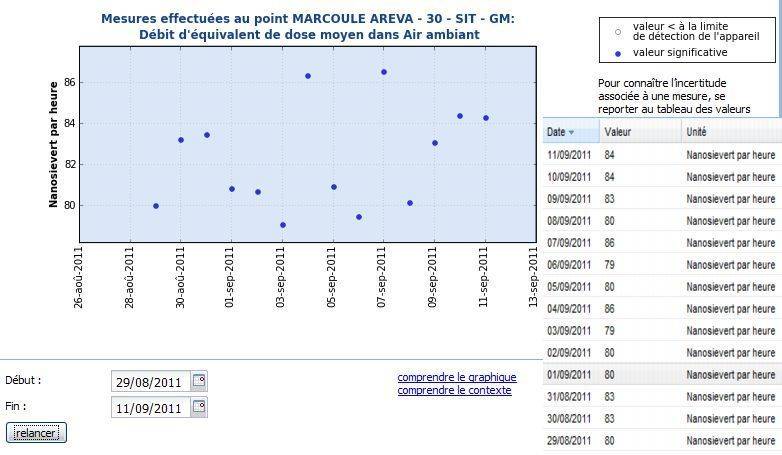

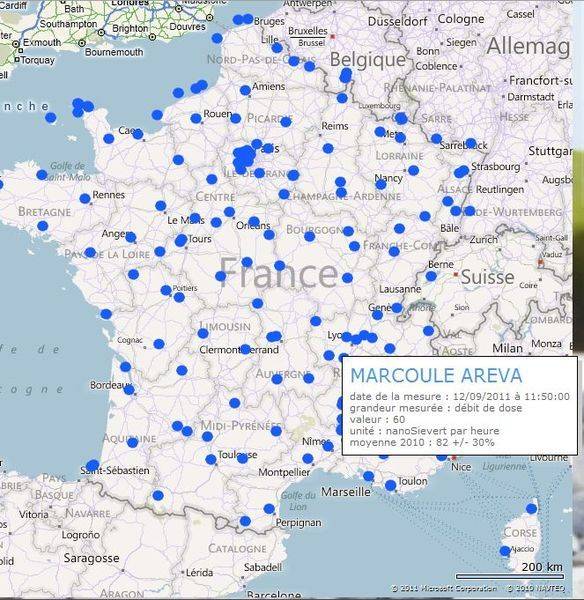

Although the header at http://www.irsn.fr/FR/Documents/france.htm claims the data are updated every 4 hours, I am not seeing any update more than 4 hours after the 11:50 AM 60 nSv/hour data.
Here are the monitoring data for the past few days :
Source: http://sws.irsn.fr/sws/mesure/index
And today's screenshot of http://www.irsn.fr/FR/Documents/france.htm

80 nSv/h is 0.7 mSv/year, slightly below natural background levels (assuming they average at about 3 mSv/year).

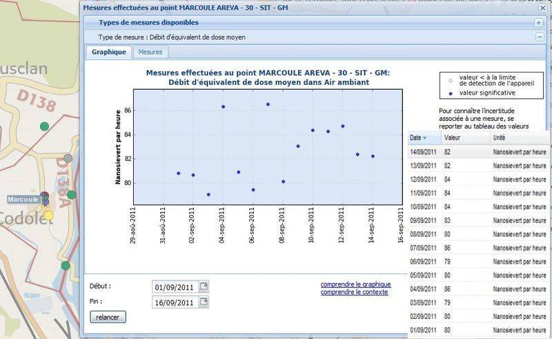

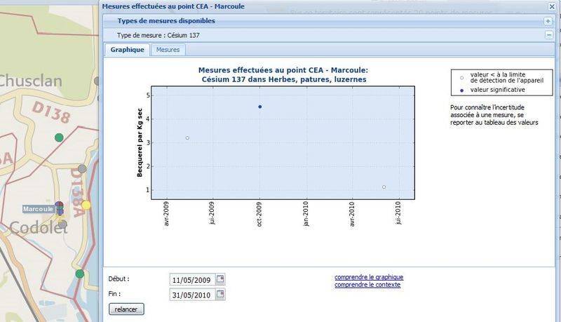

Some updates:
source: http://sws.irsn.fr/sws/mesure/index
Back in 2009 they found 4.5 Bq/kg of Cs-137 in grass:

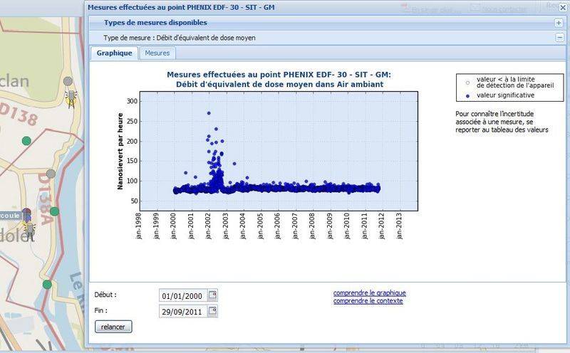

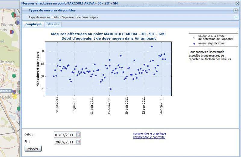

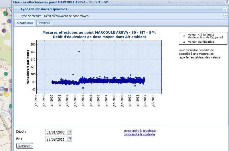

July-September 2011 trend
2000-2011 trend (apparently there was a peak in spring 2003)
2000-2011 trend further North at the Phenix EDF monitoring post (it looks like they had an even bigger problem in 2002)
There was what is believed to be a non-nuclear sodium-water explosion, without casualties, caused by heavy rainfalls, in the Phenix plant, Marcoule in September 2002 : http://www.asn.fr/index.php/S-informer/Actualites/2002/Incident-a-la-centrale-de-Phenix (not classified on the INES scale). There doesn't seem to be any nuclear event reported during those years.
