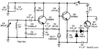

Ok I will explain in detail the purpose of this experiment. The LC circuit I made consists of a known capacitor ( 1nF) and an inductive loop (made by 3 turns of copper wire). I will make the circuit oscillate at its resonant frequency. Now when the circuit is all set up and oscillating at its resonant frequency - I will bring a conductor ( metal plate) close to the loop.
From my understanding the loop should induce eddy currents into the surface of the conductor , thereby decreasing its own inductance. This decrease in inductance will cause the resonant frequency of the circuit to change ( increase I believe ). This is what I have to measure . Accurate measurement of frequency change is very critical for me.

Some metal detectors use high frequency oscillators which change frequency when metal is brought near the coil. Frequencies in the range 100 KHz to 2 MHz are used.
Since we can't hear such frequencies, there are methods used to allow us to hear the result or see it on a meter.
One is the BFO technique where a stable oscillator is set close the the same frequency as the variable one and you hear an audio frequency ouput when the two are mixed together.
Another is to set the variable frequency oscillator to the resonant frequency of a ceramic oscillator. Then the variable oscillator output is applied across the ceramic resonator via a series resistor.
If the frequency changes, the output across the ceramic resonator changes and this is shown on a meter.

Those circuits may make sense if you understand the need for them.
If you have an oscillator giving 400 KHz and you bring a small piece of metal near it, it may shift in frequency by 500 Hz or so.
You could watch it on an oscilloscope, but you would not be able to notice the difference in frequency, because it is small compared with the 400 KHz.
So, if we mix the 400 KHz signal with another 400 KHz signal and then bring the small piece of metal near the first oscillator coil, it will change in frequency but the other oscillator will stay on 400 KHz, so then we will hear the difference between the two signals (500 Hz) as a 500 Hz sound from the mixer in headphones.
If you bring the metal closer, the sound may change to 1000 Hz, which would be an obvious change if you are listening to it, but on an oscilloscope, you would not notice that a change had happened.

:approve: Absolutely Correct ! I looked up on that metal detector circuit and now I understand its working !
