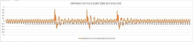

Hi I'm a beginner on using an oscilloscope and I'm sorry if my question may be repeated in other posts.
I was working on a circuit with the following materials:
(1) an Al plate (5mm thick)
(2) a disk-shaped piezo transducer with special electrodes (product note)(http://www.piceramic.com/products/piezo-elements.html)
(3) two wires
(4) a coaxial cable
(5) a Tektronix DPO4104 oscilloscope
So the PZT was glued on the plate, and wires were soldered on the PZT to connect to the oscilloscope.
I tested my setup by knocking the plate, and ended up with sudden voltage rise/drop for the knocks. But I noticed the continuous milli-volt noise signals throughout the whole process.
Are they actually noise or something else? How should I reduce them to less than 0.1V as maximum amplitude, or even none? Because I would latter want it to detect 0.3-0.4 V.
I've tried scaling, reducing record length, and switching acquisition modes to SAMPLE / PEAK DEFECT / HI RES / ENVELOPE / AVERAGE(with max value possible). But they didn't work.

The continuous small background wave looks to me like AC power frequency. It should not be stopped by a LPF because the signal has higher frequency components than the AC power. If anything it could be reduced by a HPF, but that is not the best way to go.
Reduce the area of any wire loops in your circuit layout, then you will get less magnetic field coupling from nearby AC power currents.
Is your aluminium plate grounded to the oscilloscope ground, or is it being an AC power voltage antenna ?
You might have a "hum loop" between the earth/ground of the oscilloscope and the transducer circuits. What else is grounded where ?
It could be audio noise from a cooling fan or air conditioner.

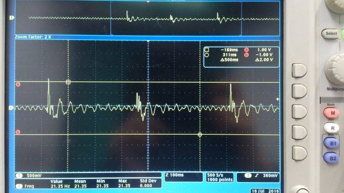

jim hardy said:
I can't make out from that oscillloscope display what is horizointal time base.
Your first question about the background should be "What's its frequency ? "
Top window of screen shows ripple. Data was gathered for two seconds at 500 S/sec.
Main window is zoom of that. The square [a] and circle (b) time markers are 500 msec apart.
At the bottom of the screen it seems to be reporting an FFT frequency peak at 21.35 Hz.
That is a rumbling noise, but the ripple looks like the sum or beat of two or three frequencies.

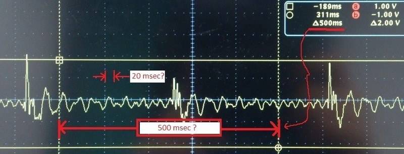

here was my best estimate
something resonates after his tap at about 50msec period, 20 hz
looks like there's ~30hz background ?
i wondered if there's a 1750 rpm motor nearby

Just to update, I tried putting a foam plastic plate under the Al plate and half of the "noise" amplitude reduced (though I want to reduce more)
It is almost certain that you have a source of vibration reaching the Al plate. It probably comes from the floor, up the legs of the table or bench.
Consider suspending the Al plate from elastic or rubber bands so that it does not rest on a vibrating surface. If it is still microphonic, try changing it's orientation to the airbourne sound.
You can trace the paths followed by vibratory noise to the transducer through the table by tapping different points on the table and observing the amplitude of the impulse detected. Look for places far from the transducer that generate a significant result, modify the mounting and repeat the process.
