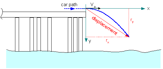

So what I found would be v_av not v_f correct? I'm kind of stuck right now because I don't think I can use equations that incorporate v_f, and those that incorporate v_i, a, d, and t all produce 13.38 as the initial velocity. I don't think I can separate this problem into vertical and horizontal components because I don't have any sort of triangle, but I get the impression that this is somehow what must be done. This is because the acceleration in directly downward, and v_i I'm looking for is directly eastward, and the distance I'm given falls in between these two. Any further hints would be greatly appreciated.
A diagram might help!
Since you didn't specify the direction of displacement (7.4 m horizontally, vertically, or diagonally from the dock), I would assume diagonal displacement.
Assuming the car fell at a 45 degree angle the magnitude of its x displacement would be 5.23 meters in .77 seconds. Without an x acceleration/assuming constant speed this would work out to a v_ix of 6.79m/s. This is also incorrect. There is still some key to solving this problem that's missing here and I'm seriously at a loss for what it is. That's a really nice diagram, by the way, gneill.
The car won't fall at a 45° angle, it will follow the parabolic path of a projectile. The horizontal velocity will be constant, but the vertical velocity accelerates downwards due to gravity. You need to use the kinematic equations for projectile motion.
That's what I thought, but I figured in the absence of all other ideas I'd give a 45-45-90 triangle a shot. I tried all of the kinematic equations for projectile motion in every way that I thought made sense and they all incorrectly lead me to a v_ix of 13.38m/s. I know that I'm using the equations incorrectly because I'm mixing vertical and horizontal components. The problem is without an angle I can't figure out how to split the given information into vertical and horizontal components.
Given some (as yet unknown) initial horizontal velocity Vo, write the expressions for the X and Y positions of the car with respect to time. For simplicity, take the downward direction to be positive, then the acceleration will be positive, too.
Thank you so much! I didn't think there was enough information to do that but, well, there definitely was.
For the sake of future Googlers coming to this page what I did was...
Take this equation: d = v_i*t + .5*a*t^2
and solved for the y displacement:
d_y = 0 * .77 + .5 * -9.8 * .77^2
d_y = -2.9m
This gives me a displacement right triangle. Using the Pythagorean theorem I determined that:
d_x = 6.8m
Knowing that this distance was traveled over .77s, and that horizontal velocity is equal throughout free-fall:
v_i = (6.8m / .77s) = 8.83m/s
