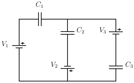

Three capacitors C1–C3, all initially uncharged, are placed in the circuit show above. The capacitances are C1=15.2 μF, C2=9.8 μF, C3=4.4 μF, and the battery voltages are V1=20 V, V2=20 V, V3=5 V.
What is the magnitude q1 of the charge on capacitor C1 once equilibrium has been established?
What is the magnitude q2 of the charge on capacitor C2 once equilibrium has been established?
What is the magnitude q3 of the charge on capacitor C3 once equilibrium has been established?
V=Q/C
I1+I3=i2
I tried applrying the kirchhoff's rule, but i don't know where to go with it... i don't even know if i am write or not.
V1+Q1/C1 + Q2/C2+V2=0
V3+Q2/C2+V2+Q3/C3=0

No figure is visible, so it's impossible to help you.
really sorry about that. I didnt realize
sabak22 said:
I tried applying the Kirchhoff rule, but i don't know where to go with it... i don't even know if i am write or not.
V3+Q2/C2+V2+Q3/C3=0
For the loop with V1+Q1/C1 + Q2/C2+V2=0: Assuming the voltage drops are for traversing the loop in a Clockwise sense, there is a voltage drop across the capacitors. This equation should be:
V1 - Q1/C1 - Q2/C2 + V2=0 .​
Similarly, the signs for the voltages across the capacitors in the other loop equation should also be changed.
Additionally, you have Q1 + Q3 = Q2, because I1 + I3 = I2 .
Plugin all the values, do some algebra and see what you get.
