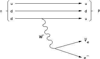

For definiteness, take :
neutron -> proton + electron + antineutrino
In principle you can collide the final state with enough energy to produce the initial state.
However at a fundamental level, the standard model tells us that this is a 2-2 scattering
All elementary processes in the standard model proceed in 2-2 fundamental scatterings.
