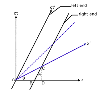

AFAIK the length contraction of the universe is not even defined.
In SR you generally speak about length contraction not length expansion. But obviously we can say that moving observer undergoes length expansion in his own simultaneity "slice".
Like in this picture:
AB is contracted length of moving rod in simultaneity "slice" of "stationary" observer but AC is expanded length of moving rod in rod's simultaneity "slice".
Obviously length contraction of universe is just inverse of moving observer's length expansion.
