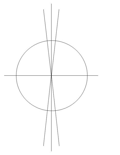

I think I see what you are saying Dalespam, however wouldn't the geodesic paths look like this?
Of course there is no scale here, it is just to illustrate that the paths narrow most where the gravitational potential is highest (iirc near the surface for Earth) and returns to "normal" (from perspective of where the light clock was released) at the centre of the body (iirc Earth has net zero gravity at centre).

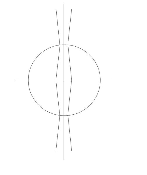

Are you saying the geodesic paths look like this image below?
The geodesics you describe in your OP are radial geodesics. Radial geodesics are, well, radial, so they would never look like your first drawing.
Think about it: there is spherical symmetry, since there is no initial velocity in the tangential direction then, by symmetry, there cannot ever be any tangential acceleration. (which direction would it accelerate and why?)

The problem is when I think about it :smile:
I thought the gravitational potential is highest at the surface, and net zero at the centre. (a quick wiki search says that gravity is strongest at the outer edge of the outer core, which is about halfway to the centre, this is where the paths in my picture should be closest)
So as the objects magically pass the surface the paths diverge as they get towards the centre of the body because of the reduced gravitational potential below the surface, and the net zero potential at the centre. (less gravitational acceleration, more distance between paths / no gravitational acceleration, no change in distance between paths, all as compared to where the objects were released which was nearly zero gravity).
I don't think the paths below the surface would be linear as I drew them, but the effect I was trying to convey is the same-ish.

Try to think deeper about what Dalespam said. Imagine tunnels through the planet so the objects could continue falling passed the surface. Your belief is that if these tunnels led to the center of the earth, the objects, on passing the surface, would veer off and hit the side of the tunnel. How? Why? There is absolutely no feature of the situation (in the ideal, where the planet isn't rotating) that is not spherically symmetric. What could cause the motion to deviate from radial?
Possibly you are thinking the speed of fall relative to Earth slows after the falling objects pass the surface. This is true, but doesn't change the directions.
the reduced gravitational potential would cause it to accelerate less, but the acceleration would still be directed toward the center. Given the symmetry, what could possibly make it accelerate left or right?
